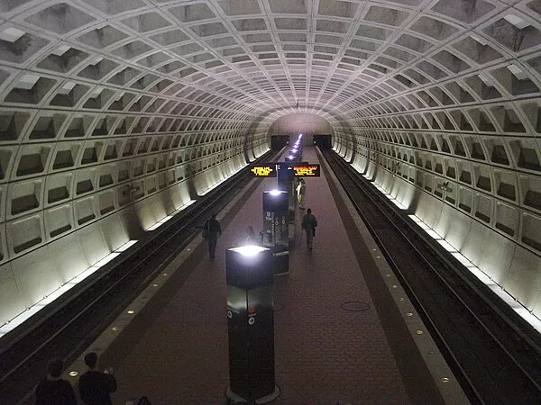

If you scale this idea up to larger tunnels running vehicles which can carry a large number of passengers at once... well, we already have that sort of system. It's called a "subway". No elevators required except to handle handicapped passengers.

Having lived in the Washington DC area, I have memories of:
