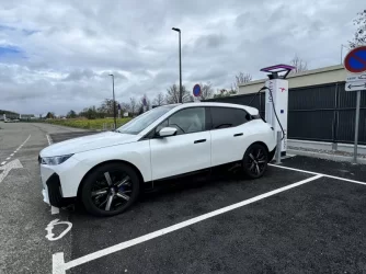

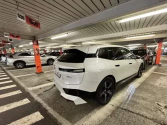

I travel to Europe often and the EV space is more interesting. Charging infrastructure is really good as well. You can get a really nice EV for the same price as an econobox. Also some cities have emission zones. I was just in France via Geneva and rented a BMW iX for 5 days, it was one of the cheapest options
