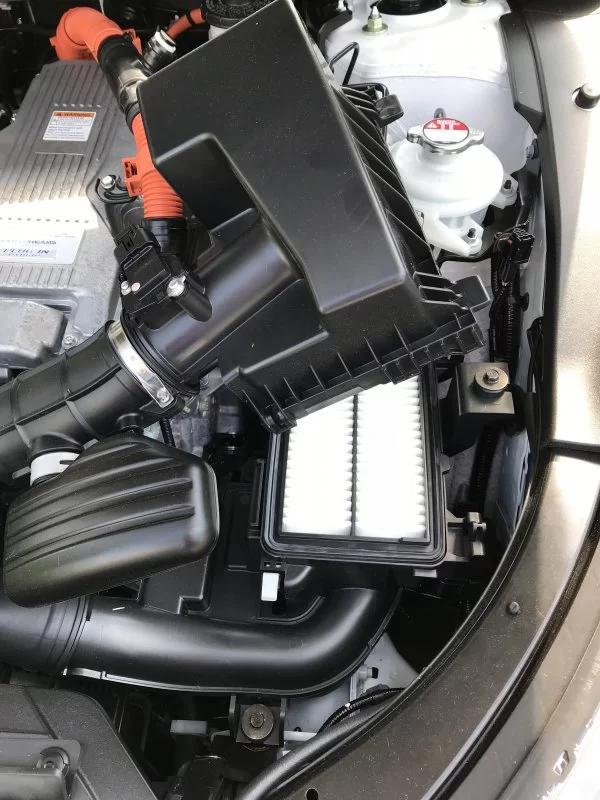

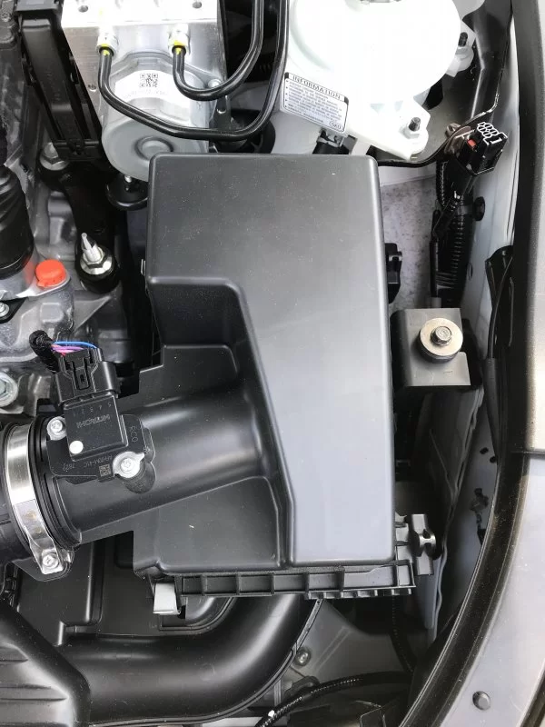

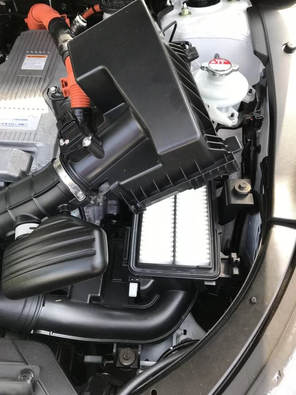

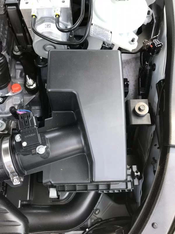

Has anyone changed their engine air filter yet? I live in very dusty Palm Springs and have almost 10,000 mi on my car. The manual said to change around 15,000 miles. I also have no idea where the filter is located under the hood. It looks like it might be on the right side - the side where the steering wheel is. There are 2 clips but I haven't tried replacing the air filter yet.
Haven’t changed it yet but yes, you have found it on the right side facing the car (driver’s side).
To open just loosen the 2 clips and pull up on the left side enough to slide the right side from under its 2 slide in brackets. It helps to pull up on the flexible hose connecting it to the engine while pushing the housing to the left and down a little. Easy peazy, lemon squeezy.
Then replace air filter noting direction of air flow is from bottom to top.
Reverse order to replace cover and you’re done. Just go slow and don’t force it and break off the tabs. It’s a very easy, quick DIY project.

Here are pix of it closed and open so you can see the 2 tabs on the right that have to slide in and out of their brackets.
