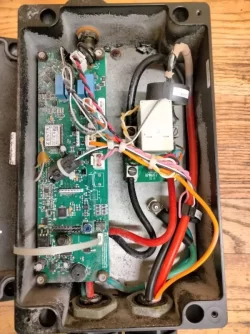

Follow-up to my Juicebox inspection:
I opened it up today and everything looks good -- all connections were very tight, and none of the wire's insulation or other components showed any signs of discoloration due to excessive heat. After powering it back on, it quickly connected to my home's wifi network but, so far, it hasn't reconnected to Enel X Way's server -- the app reports that my Juicebox currently is offline. My recollection is that, after being power-cycled, it sometimes took a day or two for my Juicebox to reconnect to their server, so this may be normal behavior.
