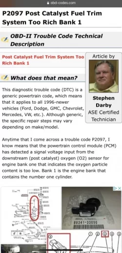

I took it to the dealer today. They didn't find anything. Code was P2097, "issue with the post catalyst", but they said they ran some tests ("AF cylinder test") and couldn't reproduce it. So they cleared the code and warning is gone for now.
I asked what "post catalyst" means, they said something to do with catalytic converter. Reminded me how those tend to get stolen a lot; we did have our car parked in a sketchy street on the day the warning came on. But if someone had messed with it I assume the dealer would have told me, they said there was no evidence of loose cables or other visible issues.
