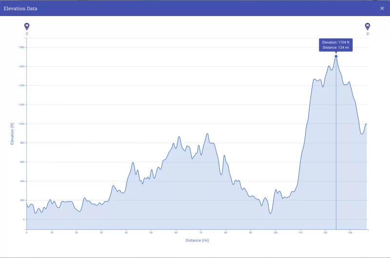

I'm planning on my first longish road trip with the Kona next weekend. The entire distance is only 137 miles to the destination. Which means I will probably have to charge on the way home. Looking at PlugShare I noted what looks like a large elevation change towards the end of the trip.
How much impact does this have on EV's and more specifically a Kona?

A lot!! I live in the mountains and range is drastically reduced when climbing up a long uphill. Good news is that regen works very well on way down, but certainly is nowhere hear net neutral. Having said that, it is no different than in an ICE car with extra fuel consumed going up. But while lots of coasting (and braking) there is no energy recovery on the way down. So you would probably fare better with an EV in the mountains, on a net % extra energy used.
I live at 4000 ft above sea level in California so am used to elevation changes.. I fugue about 30% loss in range for every 1000 feet of climbing. Like RP said you get some but not all of it back on the down side. I figure about 20 % increase in range per 1000 feet of decent. Over all on a round trip about 10% loss of range. Of course that's based my driving style and climate. One trip I make has about 2500 ft of elevation change. Its 160 miles round trip. Travailing back roads at 55mph I usually arrive home with about 75 miles of range left. Giving and over all range of 235 miles which really I think is quite good..
Looking at your graph it looks like the elevation change is not that bad. Look at the numbers! Change from ~300ft to ~1400ft. That is not that much! If it was 200 to 4000 it definitely would be different
It's all relative! The graph just looks intimidating but 1000 feet will be behind you quickly. Yes, you'll only get maybe 1.5 m/kWh but again, it'll be over quick.
I am sorry in my post it should have said 10% increase per 1000 feet of climbing. and 7% for decent. I was thinking of a 3000 foot elevation change that I used to figure out my range usage. Which is where the 30% change comes from.

Glad you corrected the rate. My Std Rng Plus Model 3 loses about 1.5%, ~3.5 mi, per 1,000 ft on the climb.
