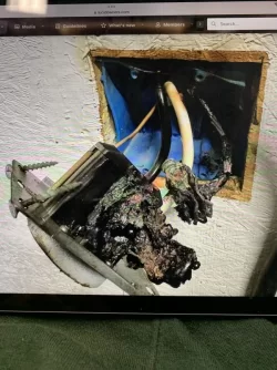

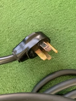

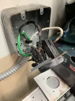

As I’m seeing new member on forum with this questions if you using NEMA 14-50 never use cheap outlet only Hubbell or Bryant as you can reserch internet to see what happens to cheap outlet as I post before what happens with Home Depot Leviton I install.If you will not using a charger somewhere else the way to go is hard wire only and electricians using those $20 outlets should recommend hard wire chargers .
