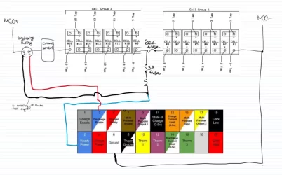

Hey guys,
I'm part of a Queen's University team attempting a go kart conversion as a MVP for a full scale conversion down the road.
We're currently getting stuck on our charge/discharge relay systems: we're using the Orion Jr. 2 BMS and AEV-250M contacts. The BMS is rated for a max of 175mA of current, but after preliminary testing we applied 8.75V to our relay to close the contact and had a current of 175mA.
I guess I'm wondering if we would be able to connect directly to the BMS or if we need to use an additional relay.
I've attached the wiring diagram for our BMS and the datasheet for our contacts, as well as a wiring diagram I've sketched.
All help is super appreciated!

As a general rule of thumb, tapping inside a battery cell series is a poor technique because the cell balancing circuit will have to work much harder trying to get both banks equalized.
A better design would use a switching regulator to step part of the full pack voltage down to operate the relay. This will make cell balancing work easily and avoid asymmetric charge/discharge of the string. Suboptimal, cheaper, a current limiting resistor or cheap, linear regulator and resistor in series across the pack keeps the cell loads more consistent. But I am not happy with simple relay power contacts.
Given the potential for contact welding and arc aging, I would recommend a snubber circuit, a series RC circuit across the contacts. This will significantly reduce the current and voltage spikes on the relay contacts.

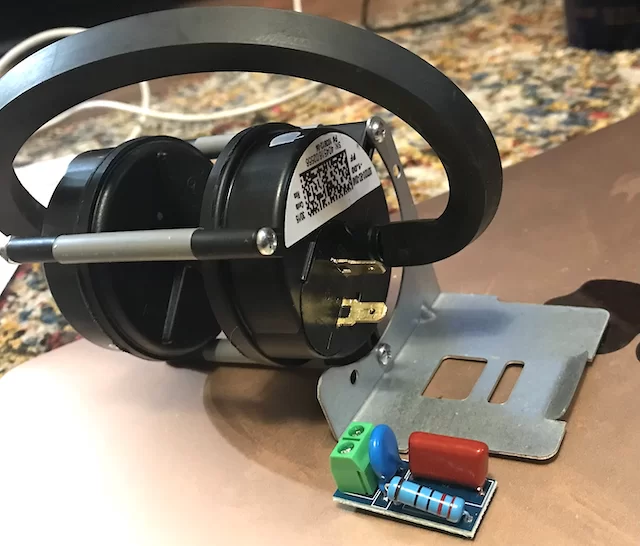

This is the furnace pressure switch that failed Friday before Christmas. This original part has notoriously weak contacts that operate an inductive 'spark generator' load, the combustion fan, activation relay. To get a single furnace cycle, I used a jumper to fake the switch, 4-5 times each day over Christmas holiday.
The replacement switch assembly, $75, came in after Christmas and the snubber(s) the next day. The jumper was cut in the middle and soldered where the former screw-down terminal was located. Taped inside the static bag, it rests safely in the furnace.
