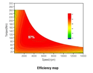

Where can i find the "Motor Torque Speed" Curve/"Efficiency Map" for the 100KW PMSM used in the 39.2KWh Kona Electric?
I have been souring the internet, EV Forums but to no avail.
I am basically looking out for this info - to understand the RPM band at which the motor operates most efficiently.

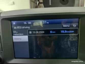

All this started when my Kona stumped with an efficiency figure of 19.2KM/KWh (that's almost like 50Wh/km)
And although i have done hypermiling experiments before, i have never been able to cross 17KM/KWh.
On this very short "Round" trip, the only differing factor from my earlier hypermiling experiments was the speed.
Hence, got me thinking what was the sweet spot for this 100KW motor, the RPM band in which it operates the best.
Desperately looking for any pointers, hints etc. Even the curve of the 150KW motor mounted in the 64KWh Kona will do.

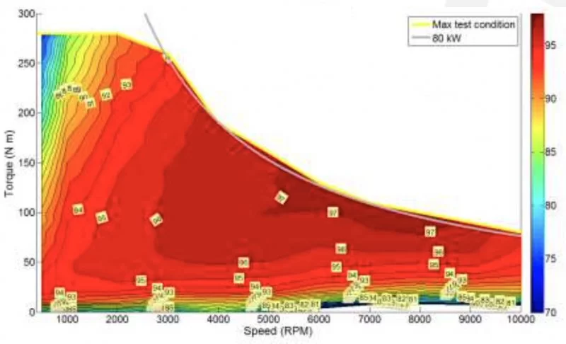

This is from an early Leaf but the motor design is very similar to the Hyundai, just smaller. The Kona 150kW motor is identical to the "100kW" motor as best as I'm aware.
Thanks, i will definitely try it out. I was trying to hit that marginal "96-97%" section.
I hope it is not quite different for the Kona 100KW motor.
Please correct me if i am wrong, but we need to take the motor rpm here adjust it against with reduction gear value and figure out the speed in kmph using the tire circumference.

The History screen in the Eco driving section seems to take the cumulative Odometer and battery SOC values at EOD. So it seems somewhat more accurate than the MID. OBD2 would be the perfect solution, but I am yet to justify that need.:D
