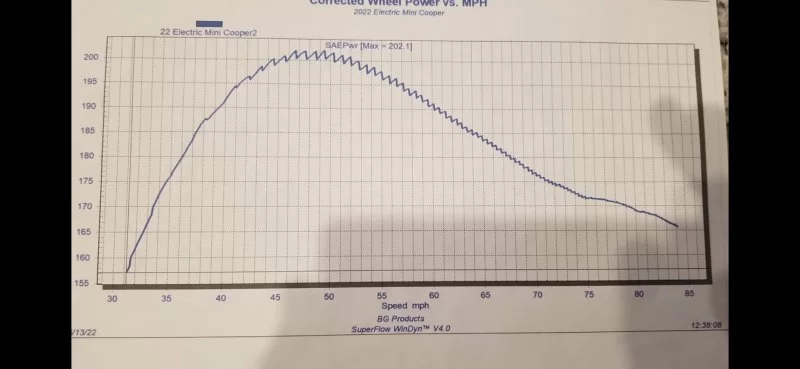

Dyno results on Cooper SE Signature
As I recall, the owner said it was the torque curve. They were unable to get a HP reading since they had no way to read motor RPMs.
Strange, as the graph is clearly labeled power, which is readily calculable (at the wheels, anyway) without knowing anything at all about what the motor is doing.
I'm wondering if it's traction control, which can't be totally disabled. And as the video states, the SE was super unhappy about stationary rear wheels.
Traction control can be disabled (as far as I know) by holding down the lever. There’s Dynamic Traction Control On/Off and all Traction Control off when you hold it down.
Yeah it isn’t fully disabled unless you delve into the “hidden” service menu and enter roller mode.
