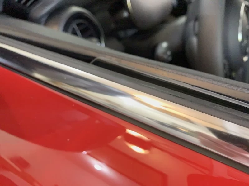

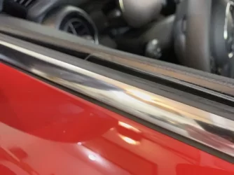

I noticed my driver window does not go down all the way, it pops up above the gaskets a slight amount. My passenger window stays all the way inside the door. I'd appreciate hearing from other owners what their window behavior is like.
I asked my service department about it and they thought it was not right, but then discovered they have other 2021 models that behave the same way (but not all of them). They're looking into it, but gathering data from other SE owners would be helpful.

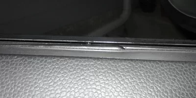

My 2021 SE's driver window goes down further than yours. When I run my finger across the gaskets, I cannot feel the glass until I get up to the front of the window. The front top corner of the window pokes up just high enough to feel it. So when rolled down, the back edge of the window is lower than the front in my SE.
I just tested this on mine.
  • When I use the "hold the unlock button on the key fob to roll the windows down" trick, both windows stop just short, as shown in @Puppethead's picture.
  • Same thing happens when I use the one-touch-down feature via the door switches.
  • But! If I tap the door switch a second time, the window goes down the rest of the way. Both sides behave this way.
