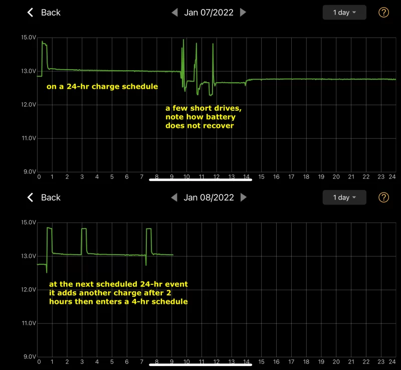

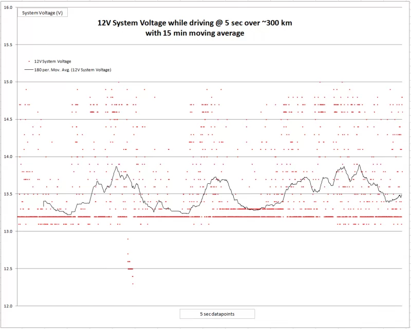

Just to be clear, the Kona does not charge the 12V battery continuously in Run mode (either when parked or while driving), only when parked and "off" (for 20 min every 4 hours) and when in Utility mode (constantly), both at 14.65 V. The original 2019 model year used to charge in Run mode for the first 30 min of the day but no longer after the 196 update. It's still a mystery as to why Hyundai changed this.
In Run mode it does however maintain the 12V system voltage high enough (13.1 V or higher) to avoid any further discharging of the 12V battery, and that's important.
Note this has changed (at least in Canada) with the new C00D111 VCULDC Control Logic Improvement update ~ November 2021:
https://www.insideevsforum.com/community/threads/12v-battery.5090/page-20#post-152098
Right after a short drive (or long) it does charge the 12V battery as I described - ~10 minutes after shut down- for 15 minutes, and every 2 hours after that. After a 24 hour period of no driving, the cycle resumes the 20 minute every 4 hours as before ;)
I don't think I have D111. If I recall I was told that update and another would be delayed until my new battery is installed.
But I do notice that I will get an added charge if the 12V battery is depleted.
Well lets hope that replacement (and updates) happens before too long .Wish I had BM2 monitor to display but I don't.
Interesting the change in charging cycle "doubles up" when the detected voltage is low.
