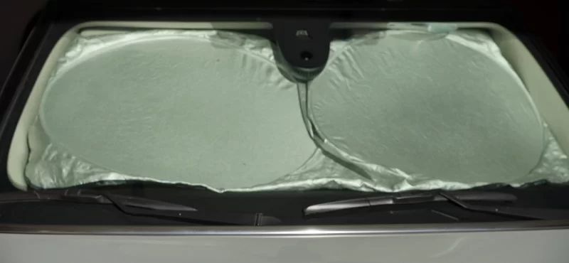

The A/C works great on Max. I am glad I have ceramic tints. I also use a windshield sunshade to keep cool. I tried out a few before I found one that was small but still able to cover. We all know space is a premium in a Mini. The sunshade was originally designed for the Wrangler and Rubicon. I have to fiddle with it sometimes to set it up.
https://www.amazon.com/gp/product/B07HZ3STTK/ref=ppx_yo_dt_b_search_asin_title?ie=UTF8&psc=1
