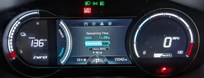

I charged my Niro (same drivetrain as the Kona) at an EA at night in the bitter cold . . . I think pre-conditioning is a gimmick, it charged starting around 60 and pretty much maintained that until it hit 75%. I drove my son's tesla on a longish trip Biloxi - Lady Lake, down to Tampa, and back. Pre-conditioning didn't seem to really accomplish much time savings or affect the charging rates much.

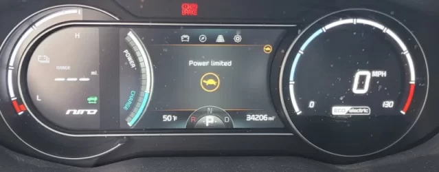

I would suggest charging the car up to 100%, then immediately take it around the block a mile or two, then hook it back up to 100%. Once charged again, run it down deep until the turtle comes on:

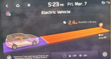

Obviously be close to home. as you get down close. Stop around 2-4%:
Then plug in and let it go back up all the way. This should set a reasonable calibration cycle for the GOM.
