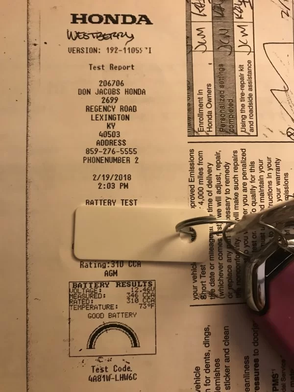

The Clarity’s 12 v battery is rated at 310 CCA and the Fit’s battery at 340 CCA so it’s only 10% less. His argument is meaningless and he’s just trying to brush you off and not have to deal with it.
The dealer is cautioned by Honda to keep both the 12v and 17 kW traction battery charged to prevent permanent damage. Evidently many are not doing this. The dealer is mandated by Honda to check the Amp Hr of the 17 kW battery and to perfom a Check of the 12v battery.
Here is how they are supposed to check the 12 v battery (taken from Honda’s PDI doc):
5. Check the 12-Volt Battery To ensure long battery life and that the customer gets a fully charged battery, you must check it at these times:
 When the vehicle first arrives at the dealership
 During the PDI (if done at a later date)
 At regular intervals (if stored)
 Just before vehicle delivery
Test the battery with the ED-18 battery tester following S/B 88-023,
Battery Testing and Replacement.
If the ED-18 does not show GOOD BATTERY, charge the battery with the GR8 battery diagnostic station.
Write down the GOOD BATTERY 10-digit code in the PDI and Final Delivery Checklist booklet.
During the PDI, write down the code in the “Under Hood - Engine Cold” section.
Then, at vehicle delivery, test the battery again, charge if needed, and write down the new code in the “Final Inspection (At Delivery)” section. NOTE: Make sure the ED-18 has the latest software installed before using it.
Your battery should not have run down in less than a week with the car off. Either there is a problem with the car charging or the battery is weak and cant hold a charge.
If I were you, I would demand your dealer show you both the PDI and the print out from his checking the 12v battery (which they should have done at least once) if you did not get them at delivery. And have them test your battery now to see if it passes. Mine tested at 346 CCA and 12.46v at 73 F at Delivery.
If they can’t produce the PDI and a test print out, then I would demand they replace your battery because they did not follow Honda’s guidelines and damaged it.

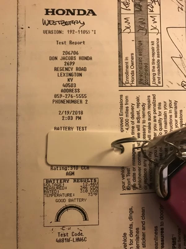

Here’s what the test looks like.
@KentuckyKen is your key fob red or is that a silicone cover?
It’s actually a purple silicone cover. It was a freebie from my dealer. I think the brand is The Jacket. Fits perfectly but doesn’t cover the chrome at top where the key ring is. I have it in my spare fob and use a Lexus leather cover on the fob I pocket (another freebie, boy am I cheap!) that keeps the chrome top from being scratched.
