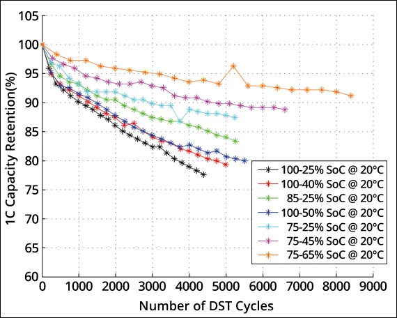

The number one reason to Fast Charge Level 3 to 80% is cost. Above 80% charging slows down and costs. You can get anywhere across Canada or up and down the west coast of the USA easily. There are always plenty of stations available. I use plugshare for planning stops and over time have found favorite places to charge. That said, according to Battery University you can charge daily (say for a commute) 250 xs a year. That would be 1000 xs every four years. Say you drove for 16 years, fast charging daily, from 25% to 100%, you would still have 80% of your battery range. Personally, I do most of my charging at Level 1, overnight in ~12 to 13 hour shots, or 60-80%. This would pretty much keep me within the orange line. So when I travel long distance, I D/C fast charge without worry, but to 80% due to cost after 80%. With good planning, I can travel about anywhere with no problem. BTW most people get a new vehicle every 5 to 6 years. Your EV battery is the least of your worries. Personally, I plan to keep mine for 20 years, depending on how new technology speeds up the charging time.
