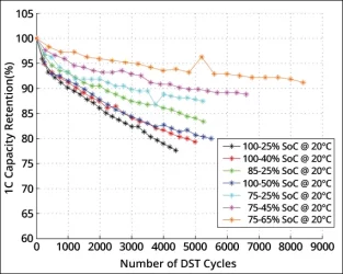

It's the "time at 100%" that should be minimised, don't worry about the process of getting there, especially on AC, or 25 and 50kW DC. But I'd avoid higher the charge rates if it was not inconvenient to do that because they may exceed "1C" of the cell capacity which is 180 amps.
Same applies to being under 20%, don't leave it there overnight if you don't have to.

This makes sense to me. Charge it up to 100% or drain it below 20%, but don’t leave it at either for any length of time.
