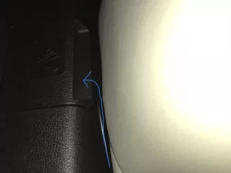

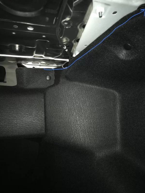

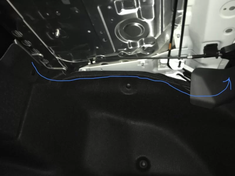

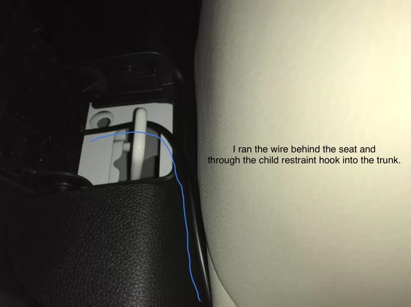

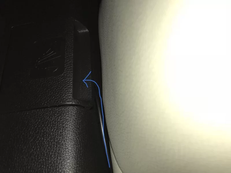

I used the back seat power outlet and ran the wire around the rear passenger seat and through the child seat anchor and snaked it through to the trunk. The power cable was just the right length.
Did you mount the camera onto the trunk hood or somewhere inside the trunk? How did you run the wire within the trunk? Could you please share a few photos of this install?

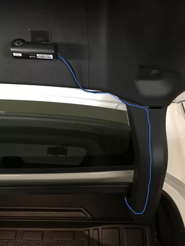

I mounted it on the trunk hood a little off center towards the right passenger side due to the cable length. I didn’t need to remove any panels installing it the way I did it. C95AD1ED-00D8-46F6-BAF2-A6D3FDA874E9.webp 175B96A7-D3E9-4E07-9392-C2C2E89DA0E8.webpFA5E2389-5648-4781-AF9C-2A118722AC80.webp 33A8B9E1-3993-451A-9D00-E33B0B32959F.webp
