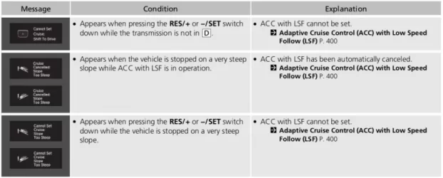

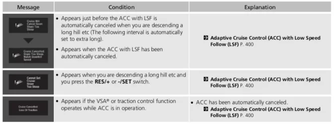

There are several references to this condition in the manual:

Right. I saw there are a lot of conditions for the ACC not working, including the "slope too steep". But the problem is it would always show the slope too steep, when I'm not on a slope or when I'm on level ground. That's not supposed to happen and something with the system is malfunctioning

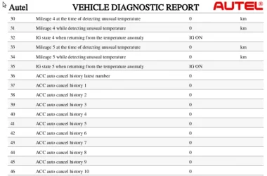

So I bought the AP200 he suggested and just got it today and started looking over some things. The VSA has a sensor called "longitudinal accelerometer", which does indicate when the car is on an incline or decline and is supposed used to calculate pitch (I tried it with live data running and it does change depending on whether the car is angled up or down). However, it reads fine.
I also checked the ACC autocancel log and they all say 0, which indicates it's not autocanceling, just showing a cruise control preventing message you'd normally see on a steep incline.
