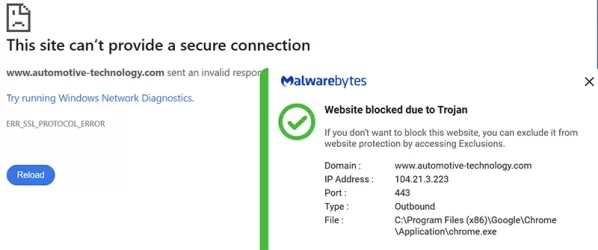

To dive deeper into EV battery care, technological advancements, and industry insights, attending expert-led sessions can be invaluable. For example, the Schneider Electric EV Battery Webinar offers a detailed look into optimizing battery management and sustainability practices. Such resources provide actionable knowledge and equip you with the tools to better care for your EV.
WARNING: Malwarebytes found a problem with the insecure (http, not https) Electric EV Battery Webinar website linked in this seemingly helpful post.
