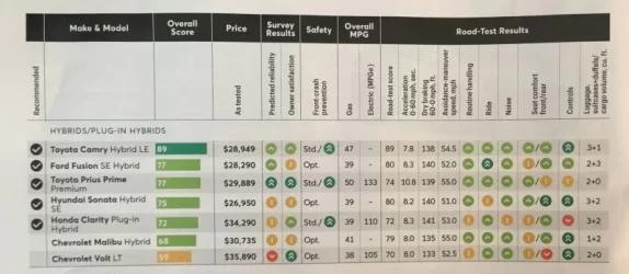

Let me first say that most people read the magazine and do not have the online subscription which goes into more detail about the Clarity. So what I add to this discussion based on the more detailed analysis might not affect decision making since few read it. Regardless, this is some of what was covered.
4/5 Acceleration: It is pretty quick: 0-30mph 3.5sec, 0-60mph 8.3sec, 45-65mph 5.2sec.
3/5 Routine Handling and 3/5 Emergency Handling: "sluggish steering and prounced body lean make it feel rather clumsy while going around corners." "wide 40-foot turning circle" but "commendable 53mph through our avoidance maneuver."
3/5 Braking: Braking from 60mph (dry) 141ft, (wet) 145ft. "brake pedel felt grabby."
3/5 Headlights: "pleasing to drive behind" "They do a good job of lighting the road, and a very good job of illuminating the side of the road." Seriously, they raved about the headlights, but gave a 3/5. (Huh?)
4/5 Ride: "absorbs most bumps"
3/5 Noise: Quiet in electric mode, with the engine "a intrusive, monotonous, and gravelly hum."
3/5 Driving Position: "plenty of headroom, well placed footrest and kneeroom." but taller people "feel they are sitting on the car rather than in it" and "Many drivers complained about the inability to sufficiently raise the bottom cushion's front edge."
3/5 Front Seat: "basic" without many adjustments including lumbar support. Easy to get in and out of.
4/5 Back Seat: "ample room...but headroom is snug for taller passengers."
2/5 Controls and Display: "frustrating" "lacks knob and physical buttons" "screen is a far reach for most drivers" "multiple steps for common tasks" "awkward gear selector" "hard to differentiate between the audio function controls and the infomation display controls on the steering wheel"
4/5 Interior Fit and Finish:"well assembled and looks elegant"
4/5 Trunck/Cargo Area: Can hold quite a bit, but isn't flat and has a small pass through. Cheap material in the trunk.
5/5 Climate System: mentioned heated seats and the climate feature on HondaLink.
Fuel Economy: There isn't a score, but they wrote that the Clarity would use 310 gallons a year (based on 12,000annual miles). They figured all the miles would be on the gasoline engine that, according to them, gets 38mpg. While figuring out the Volt, they used the 105MPGe. Prius Prime they used 69MPGe. I'm writing to them to let them know about this error.
They don't have enough data to determine Owner satisfaction (4/5) or Reliability (3/5), but "Our extensive survey data, combined with our technical knowledge, allows us to expertly predict the reliability of new and redesigned models." Yet Prius Prime, also not enough data so they are predicting, gets 5/5 on both Owner Satisfaction and Reliability. Hmm.
Hopefully this helps explain the summary that was in the magazine a little better. :)
