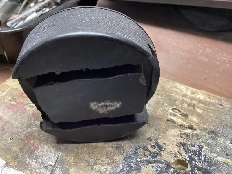

I do have a Powerflex polyurethane BMW “puck” for when jacking one corner at a time, but I’d like to put the stands under the rockers for this. I have four nice Esco knock-off stands with flat, circular pads so I’m not worried about needing three more pucks.

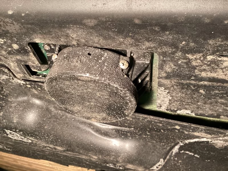

4 hockey puck router out and permanently install to factory plastic crab bc I own 2 jacks I start jacking front one side and put stand on rear bc car is balanced well with one jack I raise whole car on one side . My both jacks stay on front on each side a back of a car 2 stands .2x4 will be better but careful when you put stand do not split a wood , 4x4 “ 3/4” Playwood is better choice.only those 4 points are design to raise a car the rest services are HV battery don’t put any jacks there

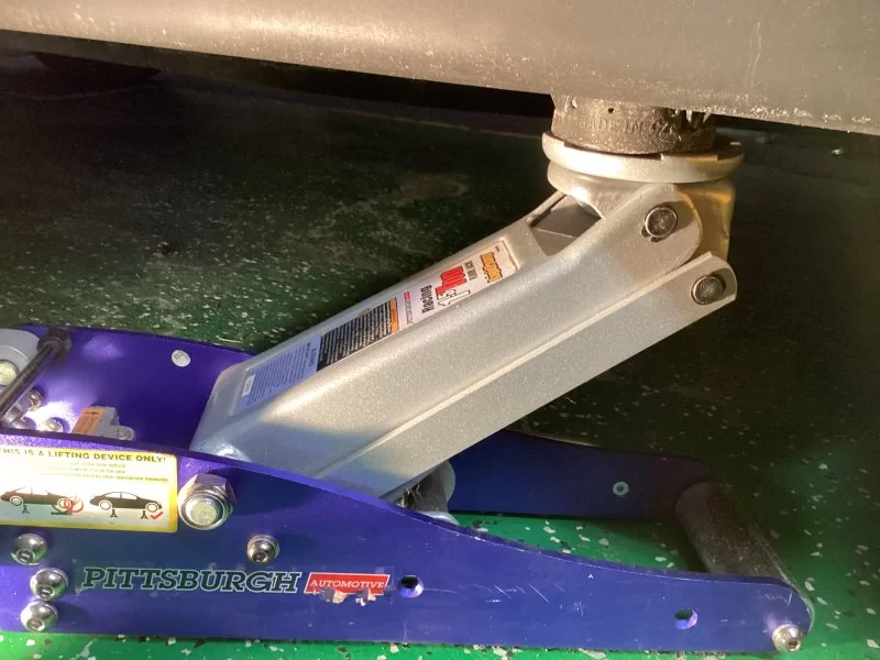

I used the front jack point to lift the car high enough to place one jack stand under the rear jack point and another one somewhere sturdy under the front of the car like the subframe.C11B09DF-C90E-4106-89CF-24F230B91AC6.webp

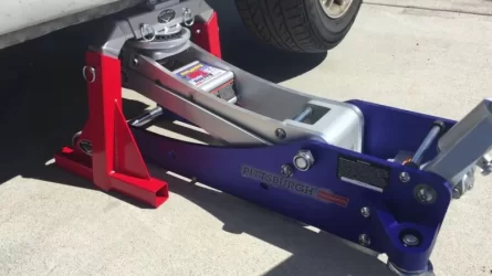

I was not thrilled with the board under the door sill solution so was planning on making something similar to the "Rennstand" or purchase a combo jack/stand if I could find one that didn't look sketchy.
