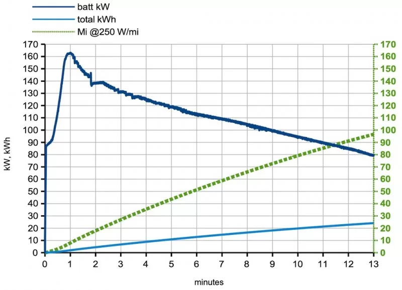

So this is a typical charge curve for my Tesla Model 3:
This is the invoice from the above SuperCharger session:
  • Tier 1 < 60 kW
  • Tier 2 > 60 kW up to my car limited 170 kW or SuperCharger max 120-250 kW maximum

With my car, the charge rate slows down to ~80 kW in ~13 minutes (12 minutes charged.) I only needed 100 miles range which is why I stopped charging.
