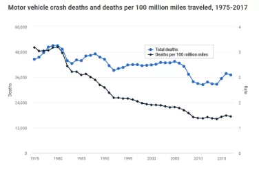

After declining steadily from ~1980-90’s through 2009-10, both vehicular and pedestrian fatalities have been increasing for the past 9-10 years.
Not to place blame on “advanced safety features” as it is a complicated issue. Simply making note that vehicular fatalities were on a solid downtrend up to the time that these features were introduced.

Very true for pedestrians (https://www.statista.com/chart/17194/pedestrian-fatalities-in-the-us-by-year/) but the vehicular deaths while up/increasing in recent years, are steady when considering the number of vehicle miles traveled. (https://www.iihs.org/topics/fatality-statistics/detail/yearly-snapshot) - so more people, more cars and drivers, and more miles traveled.
But certainly the point is valid, since all of these safety improvements should have a significant decrease in death rates - not a leveling off. So I think things like distracted driving are part of the story.
