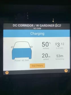

Did just this today.
116 miles round trip in a snow storm. 28 degrees average temp, cold weather package, winter mode on, cabin heat 68 degrees driver side only, good snow tires on. Enough snow on the road to block the forward radar by the end.
2.6 miles / kWH average for the trip.
Got worried about seeing 2.4 average w 55 miles to go and 45% charge, so stopped at a Chargepoint DC station to grab some extra to get home without worry.
Had only been driving 10 minutes w a cold battery, charger started at 22 kW for first 5 minutes or so, ramped up to 40 kW by the end of the short session. Charging by the minute w low rates gets expensive fast! Probably $0.50 / KWH.
