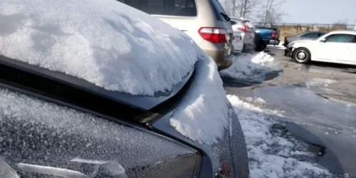

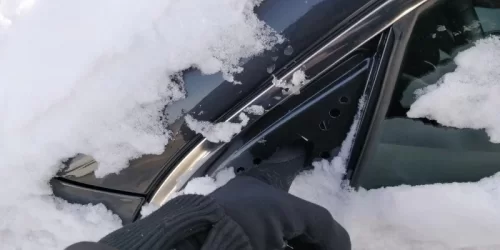

So I'm trying to deal with my insurance company over a recent collision I had with my 2019 Kia Niro EV. The collision repair facility so far has assured me they have dealt with EV's before but I was sceptical from the get go. I went in to inspect my vehicle today as the temps have been below 0 now for at least 4-5 days consistently and we have had considerable snow in the GTA. I found that my car had not moved since it was dropped off on October 31st. The EVSE 120v was in the trunk, the hood was ajar and the drivers side rearview mirror was removed with the mounting holes exposing the interior to potential rain/snow ingress. My biggest concern however was the fact that the car was completely dead, my spare key wouldn't unlock or lock the vehicle and I checked as the hood was ajar that the 12v battery was still connected.

Luckily (if you want to consider it that way, the body shop was kind enough to leave the hood ajar this whole time) so I was actually able to confirm that the 12 volt battery was still connected and that the emergency power interrupt was still in place. So at the moment it seems the car was basically bricked. No response from my key fob whatsoever. Unfortunately, I'm guessing this had already caused the body shop some problems as the driver side lock cylinder has been removed probably so they could get into the vehicle in some way (I couldn't figure out how) because I'm sure they were having the same problem with the key fob they had.
The part that really grinds me is that had I not have come to check this out, would I ever have known or been told that my car sat in the back lot of this body shop for weeks, possibly over a month (in sub 0 temps), waiting for parts without ever being plugged in... How would Kia look at that should a warrantee claim come forward for the battery?
