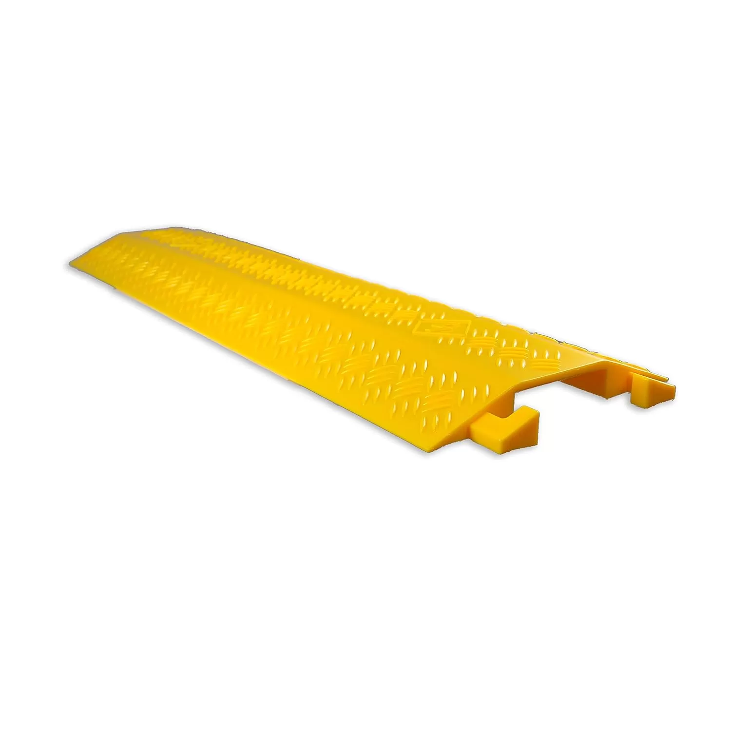

They make various cable/hose/etc covers for driveways/etc.
You can get something like the following, and cut to the desired length if you want.
https://www.amazon.com/dp/B010FH272G/
Pyle
Durable Cable Ramp Protective Cover - 2,000 lbs Max Heavy Duty Drop Over Hose & Cable Track Protector, Safe in High Walking Traffic Areas - Cable Concealer for Outdoor & Indoor Use - Pyle PCBLCO22
Price: $37.60
These get used at construction sites, and even businesses.

Yep we use these on our production floor... The only thing I don't like about using this under garage door is that you may need to adjust the door sensor since the door may think it hit something

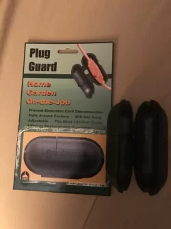

I charged with an extension cord outside for about a month unti my ChargePoint arrived (and I cleaned out the garage!).
Here examplea of the covers
Dicalimer: I’m not an electrician but I’ve worked with them and have a little common sense. Always be safe and follow your local codes with no shortcuts.

I bought the cover and it worked well for a few months, until it broke my garage door opener. It was an old one from the late 90s. I replaced it and discovered a much better solution. The garage door is now set to close about an inch above the ground which leaves room for the cable to sit underneath.
