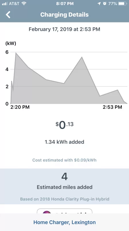

FWIW, my preconditioning on a Level 2 EVSE this winter was dirt cheap with my rate of 10 cents/kw. Above freezing took only ~15 min and around 1 kWh (10 cents) and below freezing uses about 2 kWh (20 cents) and ~20 to get the cabin toasty warm. Then on a 15-20 min trip, I don’t even use the cabin heat. (Power usage figures from Charge Point Home app).
That power draw during preconditioning goes as high as 6 kW and equates to 3 to 6 kWHs depending on the temps. No wonder using cabin heat has a significant impact on range.
I’ve only had to use my Level 2 EVSE for multiple charging in one day a handful of times and for me it’s main benefit is preconditioning.
Here is a preconditioning event starting from A Honda Link reported 40 F cabin temp and ending with cabin at 74 F. I could have stopped at 15 min and 0.9 kW (the lowest dip in the graph) as that’s when the temp first reached 72 F.
So just 10 to 20 cents to get into a toasty warm car and still keep all my range. What’s not to like?
