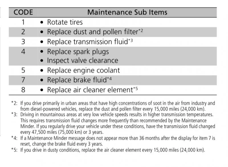

I think this has been discussed to some degree but I have a question about maintenance. Is the only maintenance required that which the maintenance minder asks for? I don't mean crazy things like perhaps not buying tires when needed, but if you have a dealer telling you to do maintenance not required by the maintenance minder, can you safely ignore?
I went into dealer for a A01 maintenance (oil, inspection, tire rotation). Car has 37500mi. They called me about 10 minutes after drop off indicating my car requires transmission fluid service for $111 plus a $232GDI/MPI Intake Service.
I OK'd the transmission fluid service and said no to the GDI/MPI until I have time to research if this makes any sense. I also did not receive any maintenance minder code for the transmission service.
Anyway, your thoughts welcome. If there are things that are maintenance related that will not come from the maintenance minder, some ideas about what those are and when to consider is appreciated.

Code 3 Transmission Fluid is based on the calendar, six years from the in-service date. At least that's what mine shows, in Car Scanner if I look at code 3 it shows a number of days remaining. If I then go to Google and type in "x days from today" it comes up with a date that is exactly six years from my in-service date, to the day. Maybe other people who use Car Scanner could try this and see what they get. Although it's possible that there is also a mileage component that kicks in if you reach a certain number of miles prior to six years, similar to how Code A works for oil changes. Since the note for Code 3 mentions 47,000 miles for severe service, then normal service would presumably be much higher than that. Further evidence being that we don't hear of anyone getting code 3 yet, although obviously that is just a small sample.
OP's car is at most four years old and 37,000 miles so they would not have seen a code 3 in their minder, and they say they only got A01 which confirms this, so the only explanation seems to be that the dealer unfortunately did a money grab.
Also I wonder what the note in the manual for code 3 is all about. Clarity would not be in direct drive mode in those conditions, ICE will just be generating electricity. So if it's an actual issue then it would seem to also apply when driving in EV under those conditions. Maybe that is the case, I don't know, but I wonder if maybe this was just boilerplate that got copied from another manual. Sort of like this puzzling statement in the manual:

The transmission fluid change frequency was not copied from the 2017 Honda CR-V model at least. This is what my wife's CR-V manual reads: "Driving in mountainous areas at very low vehicle speeds or trailer towing results in higher transmission temperatures. This requires transmission fluid changes more frequently than recommended by the Maintenance Minder. If you regularly drive your vehicle under these conditions, have the transmission fluid changed every 25,000 miles (40,000 km)." My wife's Maintenance Minder notified us at about 50,000 miles of the need for the transmission fluid to be changed. Based on this, I think the Clarity's transmission fluid change notice should come at about 95,000 miles or 6 years. (47,500 X 2 = 95,000 miles or 3 years X 2 = 6 years)
The Clarity does have a transmission of sorts so that the engine, under certain circumstances can drive the wheels directly. The tendency is for vehicle manufacturers to be conservative in the maintenance recommendations. Also, vehicle dealers make most of their money off maintenance and repairs, not sales. My kneejerk reaction is to immediately reject any additional service when I have my car in for scheduled service. My thought is that I can research it and come back at another time if it is really necessary.
I change my Clarity's engine oil every other time than that recommended by the Maintenance Minder. The oil still looks a lot cleaner than that on my wife's CR-V when I change it. I suspect that changing it every third time would also be fine. I do use full synthetic oil on both vehicles. Still, no engine has ever been damaged by changing the oil more often than needed. It is only the wallet that suffers. (I actually do the oil change myself; I do not delegate.)
And that does seem to be what the minder calculates, at least the 6 years part. We don't know what the mileage trigger for transmission fluid is unless someone reaches a high enough mileage level within six years. I remember someone using their Clarity for Uber had high miles in a short period of time but I don't remember them saying anything about maintenance minders that they had received.
