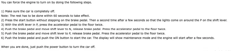

Good question Landshark. I would like to know the answer. Since at very cold temps this could be a life-safety issue, it should be tested in a controlled environment. For example, purposefully park "on the street" near home so if it doesn't work you don't turn into an icicle trying.
Here's the steps I found in this forum:
1) turn car off
Note: the rest has to be done within 60 seconds. So timing is an issue.
2) Press start without pressing the break pedal. Then a second time after a few seconds so that the lights come on around the P on the shifter.
3) with the shifter in P, press accelerator peddle to the floor twice.
4) Push break pedal and move shifter to N, release break pedal. Press accelerator pedal to floor twice.
5) Push the break pedal and move the shifter to P. Release break pedal, press accelerator pedal to the floor twice.
6) push the break pedal and push ON to start the car. The display will show maintenance mode and engine will start after a few seconds.
Due to the need to select N during the procedure, I kind of assume this should all be done on flat ground.
As an aside, at least in my lifetime western Oregon has never gotten cold enough to test this. I can't remember a time with negative temperature, let alone -22F.
