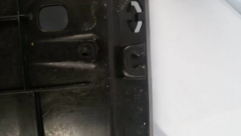

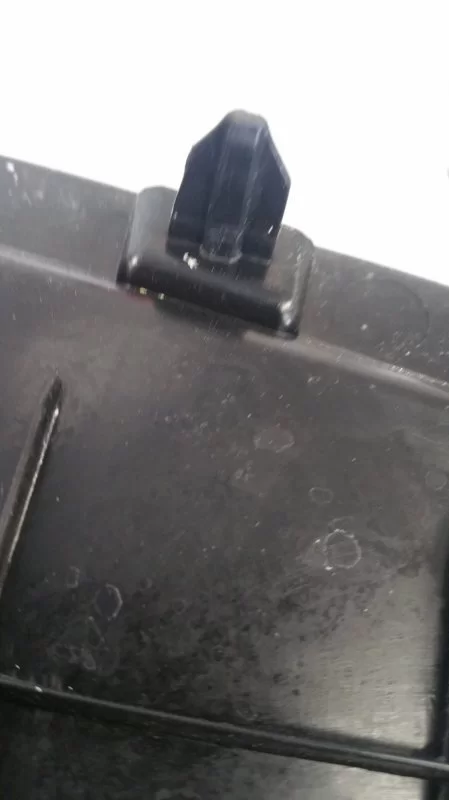

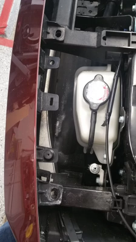

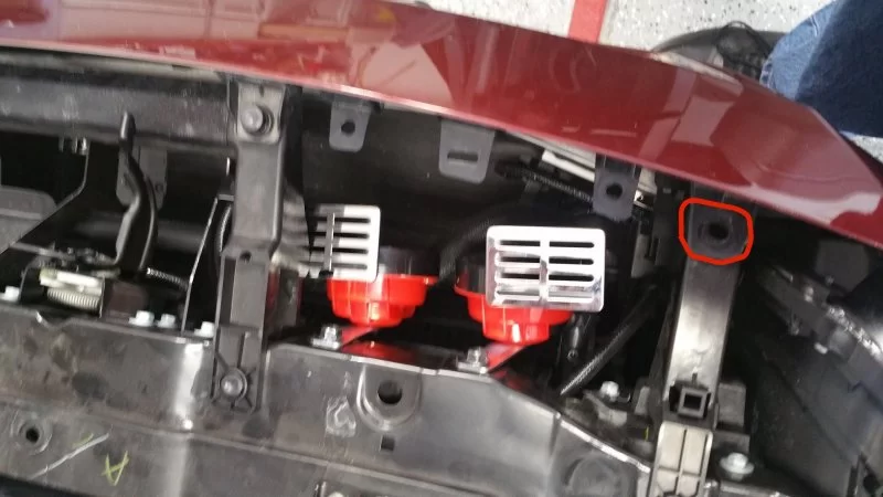

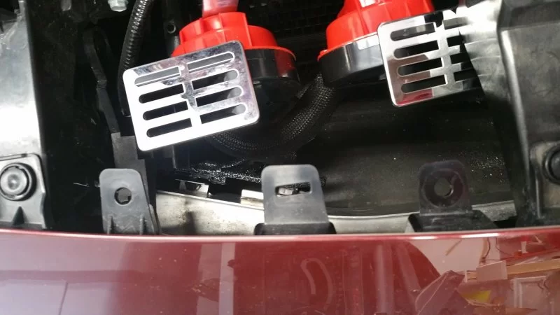

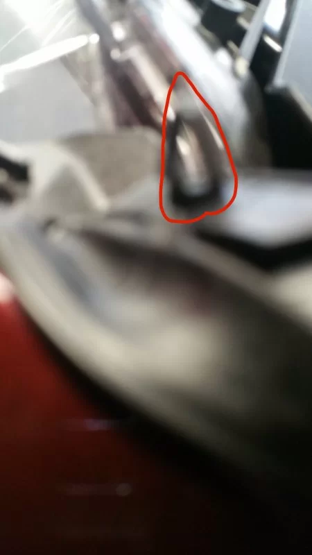

Replacing horns.
I learned a couple of things during this install.
  1. Be careful with the "pop-up" clips. Especially the ones around the rubber vent towards the back of the cover panel. Mine had a tendency to break pretty easily. Make sure your under the inner lip using the two slots cut out of the bottom half. Man I hope that makes sense!
  2. I just lifted up on the cover across the front and the clips popped loose. I noticed some tabs on the cover that inserted in slots under there that kept the cover from sliding.
Picture 1: Note the slot next to the hole. The connectors go into that hole and the slot is open to the back on the cover piece. The tab goes in the slot and stops the cover from sliding.
Picture 2: The slot in the bottom of the cover that the connectors sit in.
Picture 3: The tab on the bottom of the cover that goes in the slot in picture one.
Picture 4: I tried to get a good picture of the clip at the ends of the rubber piece that runs across the front, but the camera refused to focus on it. I've outlined it in the picture. Sort of like an arrow head. Squeeze it and it comes out. I had to use pliers because of big fat fingers, but it was easy.
Picture 5: I removed connectors from these and did not need to. There were four.
Picture 6: A good picture of the hole/slot combination the cover connects to and the larger ones I did not need to remove the plugs from
The horn installation was pretty straight forward. The connection cable on the right one is a bit hard to reach. The ones I bought were a snug fit, but a bit of tweaking and they went in.
They sound great!
