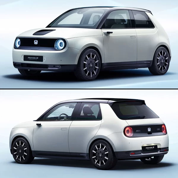

If Honda will bring their new Honda e (descendant from the Urban EV Concept) to the US, I'd pay $35K for one even if it takes 12 hours to charge and goes just 150 miles on that charge. (Note: Honda has released no specs whatsoever for this car, which is to become their first mass-produced BEV--for Europe.) I consider this car to be a work of automotive art. Honda, please bring this car across the ocean for me!
Not slated to come to the US, ever. And still behind in production for Europe.
https://jalopnik.com/honda-shows-a-near-production-ready-version-of-its-fant-1832934529
"Very soon at the Geneva International Motor Show Honda will show the latest development of that concept, and they say it’s very close to production-ready." They were saying "very close to production" last year. I wouldn't hold my breath for this to show up here.
And it looks tiny, maybe a tad bit bigger than a Fiat 500e with its rear doors. The distance between the C pillar and the rear is 3/4 of the size of the front door. I don't see 4 adults fitting in this car. Well, maybe 4 very tiny Japanese adults.
There are other options - Kia Niro Electric (not out yet, but already in production, supposedly on the boat) 300 miles est. Hyundai Kona 260 miles. Small 4 door SUV type EV. I had wanted a Niro, just didn't want to wait. Plus the 2018 Clarity deal was a very good lease deal.
Article on the e, in case you didn't see it.
https://www.theverge.com/2019/2/27/18243026/honda-urban-ev-prototype-geneva-motor-show-2019

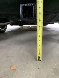

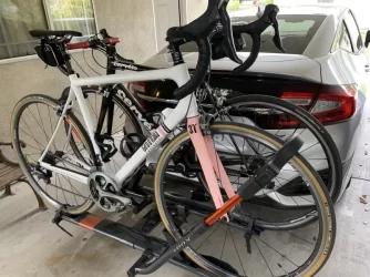

Hitch installed. I followed the included instructions and had everything off in 30 minutes. The wear guard in the trunk took the most force to remove. The tabs on the tail lights were a bit of a challenge. I ended up wedging the top one in the unlatched position with a screwdriver while pushing the side tab with my thumb and pulling the fixture rearward.

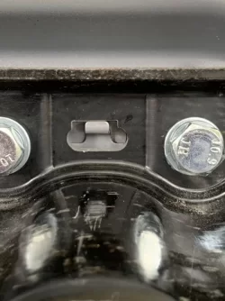

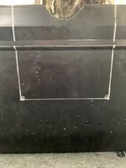

Installing the hitch and trimming a ~4 1/2” x 4 1/2” square of plastic off the bottom of the bumper trim would have taken about another 30 minutes had I not chosen to remove the hitch and plastic bumper after a preliminary fit and make a modification. I enlarged the alignment hole on the bumper with a file. The way it lined up, the bumper would not have seated flush to the hitch, due to the alignment tab on the car. Not sure if that photo loaded. If not I’ll attach it to another post.

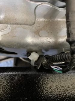

There is a wiring harness that needs to be removed from its original position. I rotated it about 45 degrees and squeezed the tabs with needle nose pliers and opted to re-secure it to the side of the original mounting position with a zip-tie.
It took another 30 minutes to put everything back together. Elapsed time was 3 hours, which included a trip to Home Depot (45 minutes), tool gathering, head scratching, a nature break and clean up.
Here’s a list of required and optional tools.
Required:
Flat screwdriver
Phillips screwdriver
5mm hex wrench for trim screws
Ratchet wrench with 6” extension
8mm socket for taillights
14mm socket for factory bumper bolts
19mm socket for new hitch bolts
Option buy probably necessary:
File
Tape measure
Marker/Silver Sharpie/White grease pencil
Square
Hacksaw/Dremel
Drill motor and drill bit, ~3/16”
Zip-tie
Wire cutters
Needle nose pliers
Utility knife
2-3 furniture pads
Flash light
Telescoping magnetic retriever (only necessary if you happen to drop one of the tail light nuts, but I can’t imagine that would happen to anyone).
The photo of the bumper mod is the last attachment, didn’t load as full image.

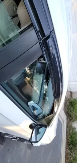

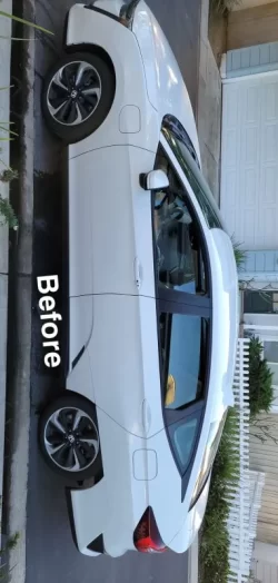

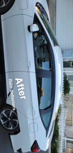

Decided to purchase some rain deflectors for my Clarity. I imagine they have a negative affect on efficiency and wind resistance but they function as expected so no complaints here. Install was pretty simple, clean the door trim with alcohol, stick each side down, and peel off the adhesive covering tape while pressing down on the freshly exposed adhesive. No issues with them falling off. I noticed a little more wind noise than usual at first but I think I've gotten used to it. The utility and look beat the noise issue for me.
