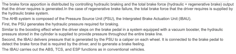

Here's my $0.02 worth.
There is a motor-driven hydraulic cylinder that provides a power assist function to the pedal under friction braking, but also provides pedal resistance under regen, aided by a mind-bending arrangement of solenoid and check valves,
I'm assuming you've powered-up the car with the caliper pistons retracted somewhat, placed out of their normal short reach to the pads and disks.
On power-up self-test, like other ABS systems the pump activates to contact the disks and establish or verify the working range. If the power cylinder reaches the end of its travel, or at least exceeds the travel it expects to use it could fail the test. A traditional ABS pump on an ICE car is a vane type that has no limit to the fluid volume it can move, but not in this case. I suspect (well, I'm certain) that a ball-screw driven cylinder pump is used because the relationship between motor torque and fluid displacement is linear and bidirectional, with low hysteresis.
Once the piston is sensed to move further than expected, ABS and all related brake functions are going to fail their initialisation tests and the system will default to what they call "backup operation", emulating a conventional non-boosted hydraulic brake system.
I haven't tried this yet but I would expect that after flushing the system or replacing/cleaning pads and disk, you should pump up the pedal slowly before power-on. Until I understood how it reacts, as a precaution I would probably disconnect the 12V battery while working on the brakes.
