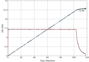

The "Normal" charging behavior of the Clarity tapers the rate down during the final 10-15 minutes as the battery reaches a 100% charge. I believe this is because during this time, it is doing some sort of cell balancing. So here is what a 'normal' full charge looks like:
The red curve is the input power (kW) and the blue curve is the cumulative energy (kWh). With a fully capable Level 2 charger, the Clarity charges at about 30 Amps (7.2 kW) at a constant rate up until it reaches near-full capacity when the tapering begins.
The amount of energy that the battery will take changes somewhat over time because of expected degradation. The rated capacity of the battery is 17 kWh, but the Honda Engineers held some of that capacity in reserve in order to prolong battery life so that much was never available for use. In my experience, when new, my usable capacity was around 14.5 kwh (bought car new in 2018). It is now more like 12.x kWh.
