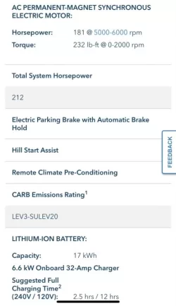

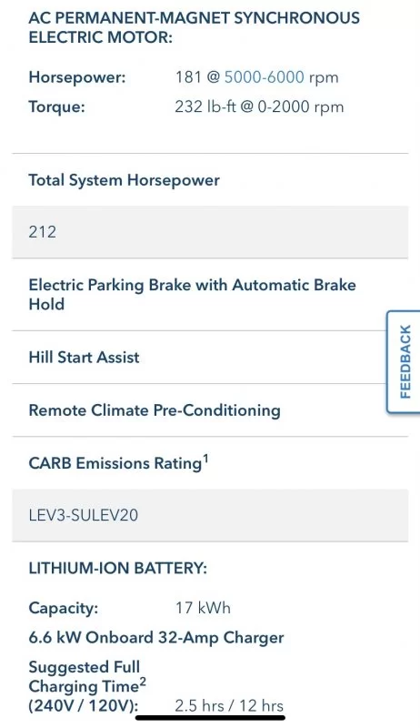

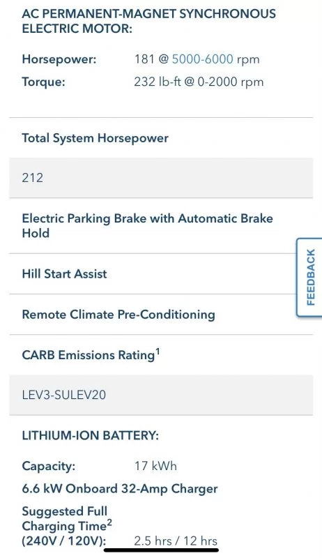

After fully discharging the battery (well, as close to fully discharged as the Battery Management System allows), it takes me just a bit over 2 hours to charge my Clarity PHEV at 240 Volts. The Clarity can accept 7.7 kW at 240 Volts and 7700/240 = 32.08 Amps.
According to this the Clarity PHEV has a 6.6kW charger. That would put it at about 28A. It would nearly cut the charging time in half from a 16A 240V EVSE.
This 6.6 kW rating is indeed consistent with all the documentation I have seen from Honda.
However, I know from my own experience (and others in this forum) that the Clarity exceeds this by nearly 10%. If not otherwise limited by the pilot signal in the EVSE, the Clarity will draw 30 Amps @ 240V = 7.2 kW. It is possible that Honda updated the onboard charger, but never fixed the documentation accordingly.
The spec as stated by Honda is a little odd anyway because it says 6.6 kW, 32A. This inconsistent with itself given a nominal 240V input.
