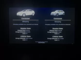

I bought two OpenEVSE units purely for their APIs so that I could write a web app and run it on a raspberrypi in a 7” touchscreen “frame” to sit in the living room and show me live status.
Whether each unit is sleeping or available (they only provide power during the night) and whether or not the car is connected. Plus pull the session stats to store and calculate charging cost (which is currently zero due to the free at night plan).
