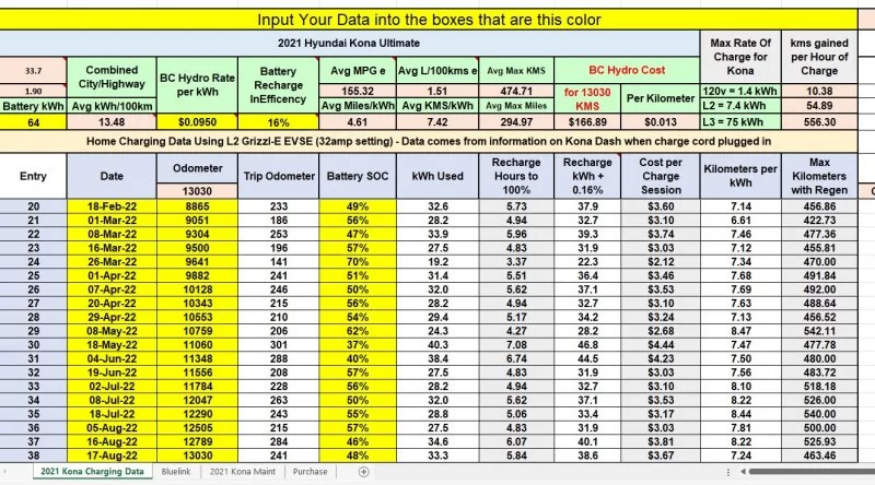

I charge my Kona to 100% all the time on my level to home charger, I usually do it when the battery get to 50%. I made a spreadsheet to keep track of the data and have been for 1.8 years. If you look at the screen shot of my spreadsheet you can see that the number of kilometers or miles varies by time of year and also where I have been driving. The GOM isn't always correct, but my spreadsheet always tells the truth.

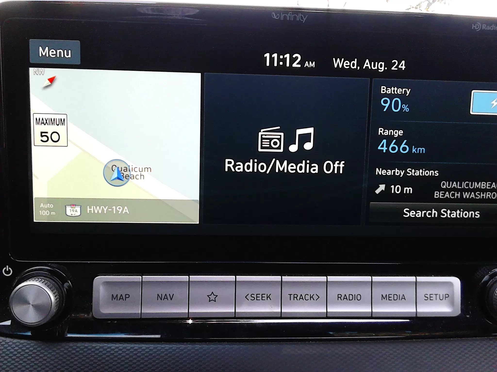

Vancouver Island's climate is also mild, but not very flat or stop and go traffic. The GOM usually put me at over 500kms
Here are the next 19 entries

A lot of good info there, thanks for posting. Pretty close to what prospective EV buyers ask me about charging costs. I generally tell them "on average" $0.0125 summer and closer to $0.02 winter per km. Its a thrill to see their faces light up when I inform them:)
