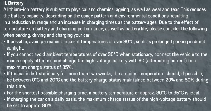

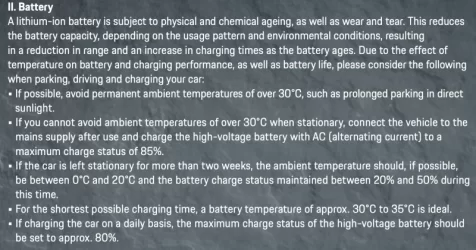

Just as a comparison, here's the info provided in the Taycan brochure rather than just in the owner's manual where you probably wouldn't find this out until you bought one.

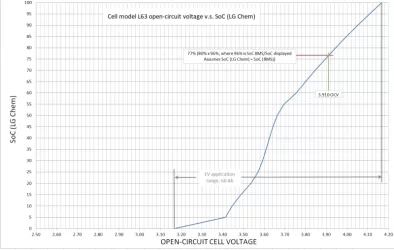

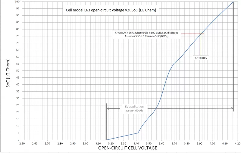

The best I understand is that Hyundai state that the battery we have is rated at 64 kWh and 180Ah. Any capacity outside of that is unavailable to us and therefore is only of academic interest, described below. A hint is that the cell model is "E63" which would certainly refer to a basic Li-ion capacity of 63Ah, however Hyundai advertise 60Ah where of course 3 x 60 = 180.
The cell datasheet from LG Chem (see link in the battery chemistry thread) indicates that the basic maximum cell voltage range is 2.50 to 4.20 OCV (as typical for Li-ion) but also implies that for an EV application that needs to be limited to a range of open circuit voltage of 3.16 to 4.16 V, which they define as SoC 0-100% using a table of values. See the graph I made from their data below, ignoring the notes at 3.190 OCV.
However, the LG Chem life tests at the end of the datasheet are based on using only up to "97%" of that range with no explanation provided. Additionally, we know that our displayed SoC is about the same as a BMS SoC of 95 to 96%.
It seems likely but not proven that our SoC(BMS) is the same as LG Chem's SoC definition and that Hyundai map that AND the top 3% LG avoid using to 0-100% for the dash display. E.g, 0% is the same for both and 95-96% is mapped to 100% displayed. The only fly in the ointment in this explanation is that we know we can reach 4.165 OCV at 100% displayed SoC so I'm not certain how that 3% fits in.
