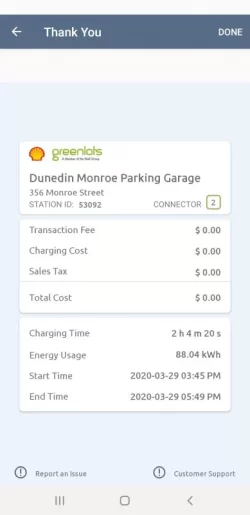

I'm charging right now on a free 50kw charger.. At this point, I have added 32% of charge and the charger shows 44.8kwh delivered.. As the Kona has a 64kwh battery, this would indicate a very high loss.. Can this be accurate? I will charge to 85% and see what total kwh will be delivered for 69% of charge.. If it charges at that efficiency, I should receive more energy than the battery size..

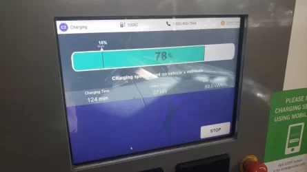

I will charge at another charger to see if it was an issue with the charger.. The car showed 42kwh to 49kwh charging speed as did the charger. based on the charging time, I indeed received 88kwh. It appears to be a loss at the car. If this happens again at another charger, I may have to bring the car to Hyundai to have it checked.. Something does not seem right.. There seems to be parasitic loss when charging DC.. On my home EVSE, the numbers seem right with about 10% loss.. The DC loss seems to be about 50%.. That'a insane.. Air temperature was about 93F, 34C... Maybe battery cooler came on but 50% loss from that?
just to add, I ended the session at 79%. So, charging the car from 16 to 79 percent took 88kwh. That'a a 50% loss somewhere on the car. Over 2 hours, mostly at 42kwh to 49kwh between 16 and 75% SoC and about 34kwh after 75% SoC

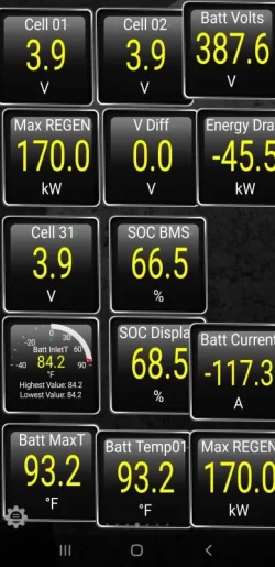

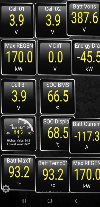

Do you run Torque Pro- curious of the temp and voltage of each cell group.

I should have run Torque Pro during the charging.. I will certainly run it next time on a DC fast charger.. I'm sure that the car received 88kw as it matches what both, the dash and the charger indicated. I just don't know where the excess charge went.. I'm sure that TMS came on.. It always does come on when I charge during hot weather on DC fast. However, I can't see how TMS can pull 30% or so from the charge current.. Weather has been unusually summer like lately but a cold front is coming through, forecasted to cool us down from 34C to 30C but nights will drop down below 15C.. That will be nice..
Another thing that I noticed was that the charger actually indicated SoC BMS, not SoC Display..

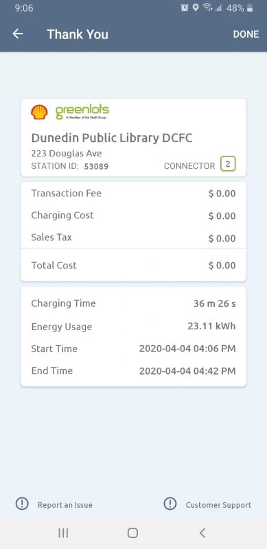

Charged again on DC Fast on a different charger and this time I had no unusual loss. TMS came on during the last 10 mins of the session, so it ended up taking 36 instead of the predicted 34 minutes. Outside temp was about 10 degrees lower than when I had the original issue.. 83 F/28C vs 93F/34C last time. Charged from 47 to 80%.
Monitored the charging process with torque pro and the numbers on the dash matched both the numbers shown on the charger as also on Torque Pro. No parasitic loss this time.

Didn't see any similar issue with that charger.. Weird thing is that according to the dash readout, the 88 kwh delivered match the average speed and charging time.. It's so weird.. I don't really think that it's an issue with the chargers. Of course, if the dash readout would have been for example 44 kwh speed and the dash read 22 kwh, I would say that it was an issue with the charger but everything displayed on the charger mirrored what the dash readout showed. I did watch the dash readout for the first 44 kwh delivered and I never saw a difference between the charger kwh readout and the dash kwh readout..
