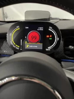

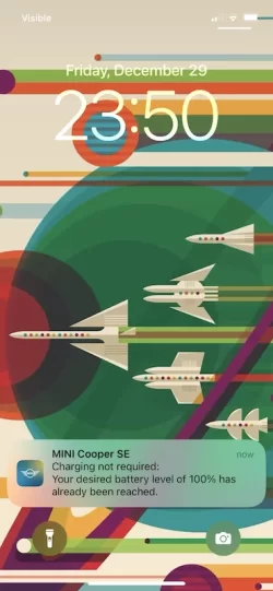

I recently got the same notification when I plugged in my SE at a full charge, so normal but is it a new notification from the app?
I haven't seen it before, but tbh I don't think I've re-plugged at 100% other than while diagnosing the recent problems (and as it was below 100% – even just a smidge – it would charge for a short bit).

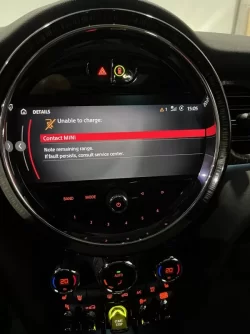

As I was turning on the car today I saw a notice and graphic flash across the instrument cluster, something about unable to charge, but the notice flashed by so fast I didn't catch the reason. I think it may have been a left over notification that clears shortly after tuning it on, perhaps from unplugging. I don't recall seeing that notification before.

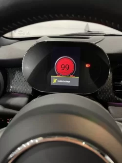

This morning was a fail for me, I think. I left the car plugged in all night, 100% charged. Solid green light on the charger. Used the app to initiate pre-condition. And within a minute it started to warm up. Cool... I did not open any doors, just observed. Within a minute the car display indicated unable to charge. The charger indication stayed solid green. Does this mean its warming up on battery only? I waited a minute but the charge failure remained. Perhaps not patient enough?
If I recall correctly, I could turn off the warm up via the app, but that did not appear to work for me this morning. Maybe never did. Toggling the on off switch didn't stop the warm up. Selecting D and then back to P, then turning off the car stopped the warm up. Battery now at 97% indicated. After plugging the charger back in, it negotiated and topped off the battery.
So apparently warm up was initiated, but it was drawing off the battery.

I did not turn wifi off. Today it seemed to revert. It was plugged in overnight (100%) then I asked for precondition this AM which worked but after about 30 seconds the "cannot charge" error popped up on the dash, and the battery drained. The charger's green light stayed steady. An hour later I unplugged the charger and canceled precondition (dunno off hand if it times out anyway). It then failed to negotiate on the subsequent charger plug in until I reinserted it a couple times.
