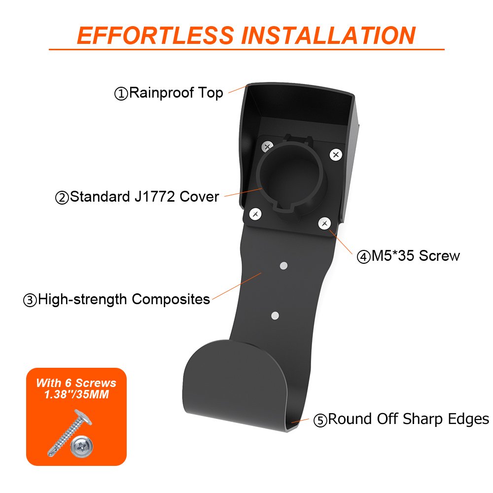

1) ALWAYS plug the charger handle into a receptacle!
You can buy a receptacle/holder on Amazon cheaply.
You don't want any condensation to collect on the contacts.

Examples of charger receptacles:
https://www.amazon.com/BougeRV-Wall-Mount-Connector-Holster-Electric/dp/B07CP3J95D/
https://www.amazon.com/ORIGINAL-evCHARGEsolutions-Cable-Dock-Electric/dp/B06XRPQY2Q/
https://www.amazon.com/AmazingE-Charging-SAE-J1772-Wall-Mount-Connector/dp/B072MP3N1Y/
https://www.amazon.com/EV-Charger-Holster-Electric-Included/dp/B074DN623C/

I am going to look into getting one of those outdoor hanger/receptacles. Right now I either hang it in the garage or coil it up on top of a plastic hose reel outside. Never thought about moisture getting into the contacts if it isn't plugged into a receptacle.

Wondering if anyone's used the AmazingE connector for their supplied level 1 charger. Looks like more weather protection than the BougeRV. Does the cap that's on a tether on our connectors fit when holstered?
