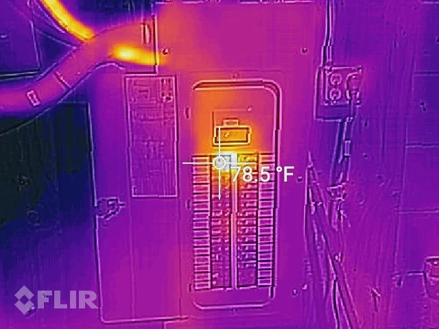

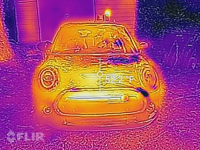

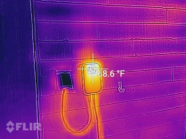

Thanks for this info and pics and the notations for temps. Sounds all good.After an hour of 'Maximum Amperage' charging mode (charging from 70%) - Got the FLIR camera out and wanted to check to make sure my wiring was up to the task of the full capacity of the charger in the car. Max temp found wasn't above 80F (27C) and even though my sub-panel is 250ft away from my main panel, I only measured a 20VAC drop at full load. Overall, I'm quite pleased. Word to the wise, make sure everything you have is up to the task of a sustained 32A @ 240VAC before you select that 'Maximum' mode in your car. (all FLIR images captured at 46F (8C) ambient temperature.
EVSE (I suspect the 'hot spot' is the contactor coil being energized and no real resistance inside the box):
Car (had been sitting for over an hour after a 30mi trip and was curious as to what the hot spots would be):
Main Panel (50A Breaker and 6AWG line headed out of panel are hot spots):

BTW: I'm using a Clipper Creek evse. They recommend that when charging, if you have some of the cord wrapped around the evse (as for storage when not charging - in other words you don't have the full 25ft of cord extended from the evse to the charging port) you should make the unused footage wrapped on the evase hang loosely to avoid heat building up in the cord. This I think would be so for any mfg's cord.
