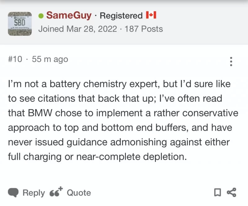

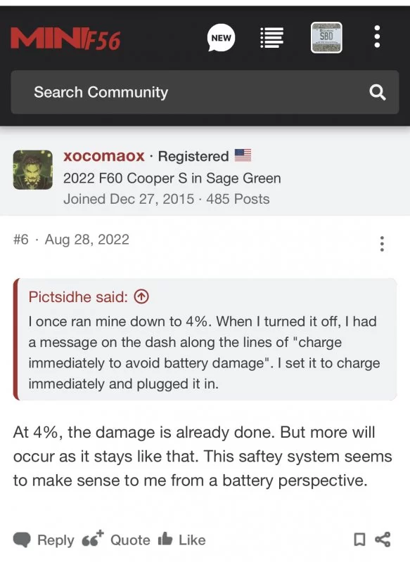

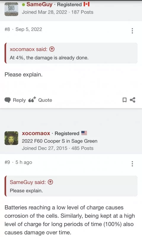

Perhaps coincidentally, there was a post in the SE forum at the MINIF56 group last week that brought up a similar subject, and got a reply that set off some flags for me.

For the AGM 12V accessory battery, yes there can be corrosion. For the high voltage battery in the SE, it is fine.
Yeah but if the 12V goes flat while the HV battery is below zero, the interlock turns on and bricks the car. Even when the HV goes to “zero,” there is plenty left to maintain the LV battery’s SOC.
The guy in the screenshoted post above is correct but he is not appreciating the buffers BMW put at the top and bottom of the pack. I suspect the bigger buffer is at the top.

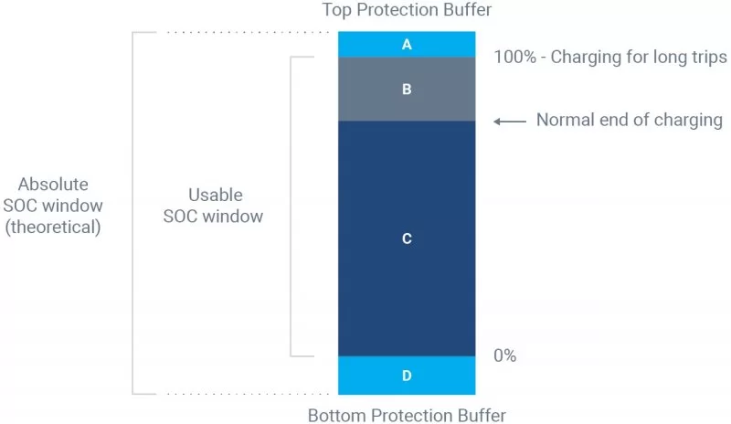

Here's an image I collected in the early days of getting my SE, not sure where I got it and it doesn't seem to correlate directly to the SE, but it's a good illustration of the buffering.
