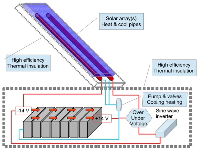

I hesitate to suggest this but it may be possible to fabricate a Harbor Freight trailer with solar cells and 'cheap' batteries to collect sun light and when the cells are charged enough, enable an inverter to drive the J1772 adapter. Of course appropriate security measures would be advised and the batteries and inverter need weather protection and temperature management.
Mounted on a Harbor Freight, trailer, there are two subassemblies:
  • battery/inverter - this houses the batteries, a sine-wave inverter, coolant pump, and controller. The controller is designed to maintain safe battery temperatures. In cold weather, any latent heat from the solar array is brought into the battery compartment. It must be air and water tight.
  • solar array - holds the solar panels with a proper solar array management controller and copper/aluminum loop holding broad temperature, non-conductive coolant (i.e., alcohol or light oil.) In the winter, waste heat goes to the battery box. In the summer, excess heat is dissipated on the shade side. At a minimum, 113 ft. sq. but larger is possible with folding array(s).
My expectation is enough kWh to sustain the car battery in winter and certainly adding significant mileage in temperate seasons.

For the solar alternative you should be able to skip the batteries by using something like a myenergi zappi charger. They're rated for outdoor use, and dynamically adjust charge current based on solar generation.
