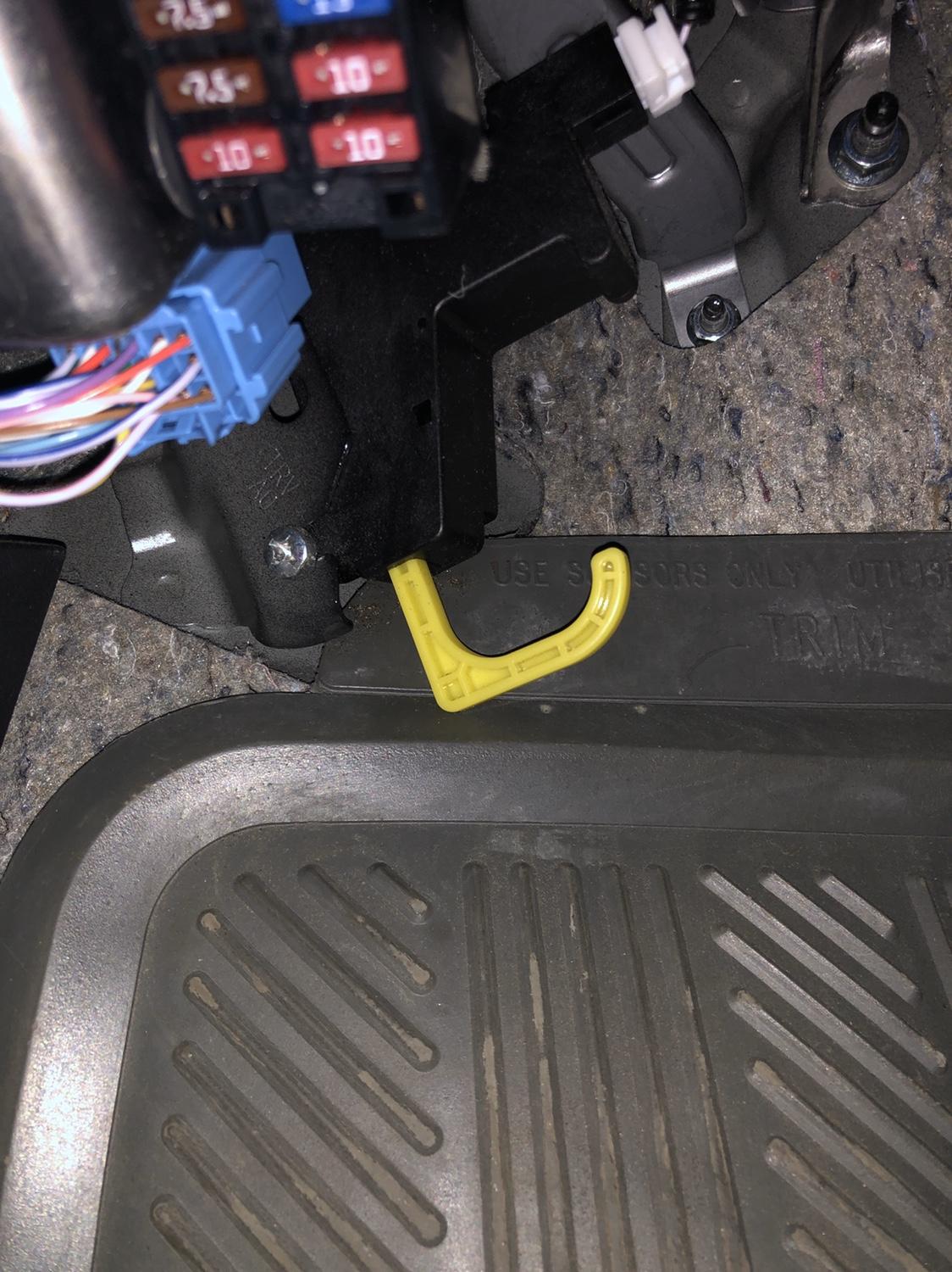

There is a questionably placed yellow “L” shaped manual charge door release down by your left foot. I have unknowingly hit it or caught it with a pant cuff more than once.
I had to go out in my garage with a flashlight to look for it. Sure enough a yellow L shaped release is there above the dead pedal rest. Learned something new today!

Here is a pic of the manual release lever
Great observation but I don't see how I could pull it with my feet unless I was driving barefoot!

I have been meaning to post about this for a while. Mine will do that once every few months. I've even had it happen while I was just cruising down the highway. I wonder if somehow I might inadvertently be snagging the yellow hook, but I also wonder if maybe something isn't hooking just quite right every time with the latch.
