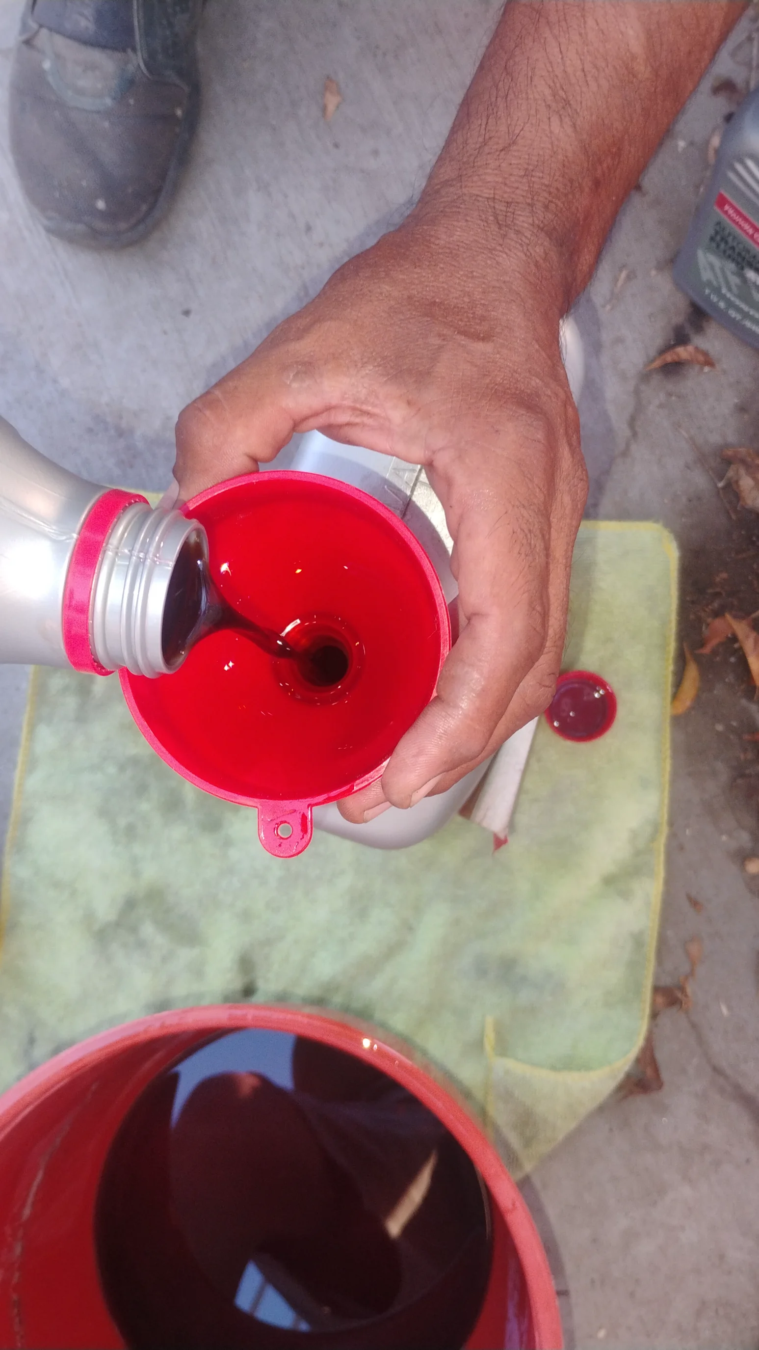

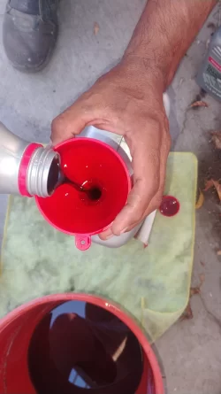

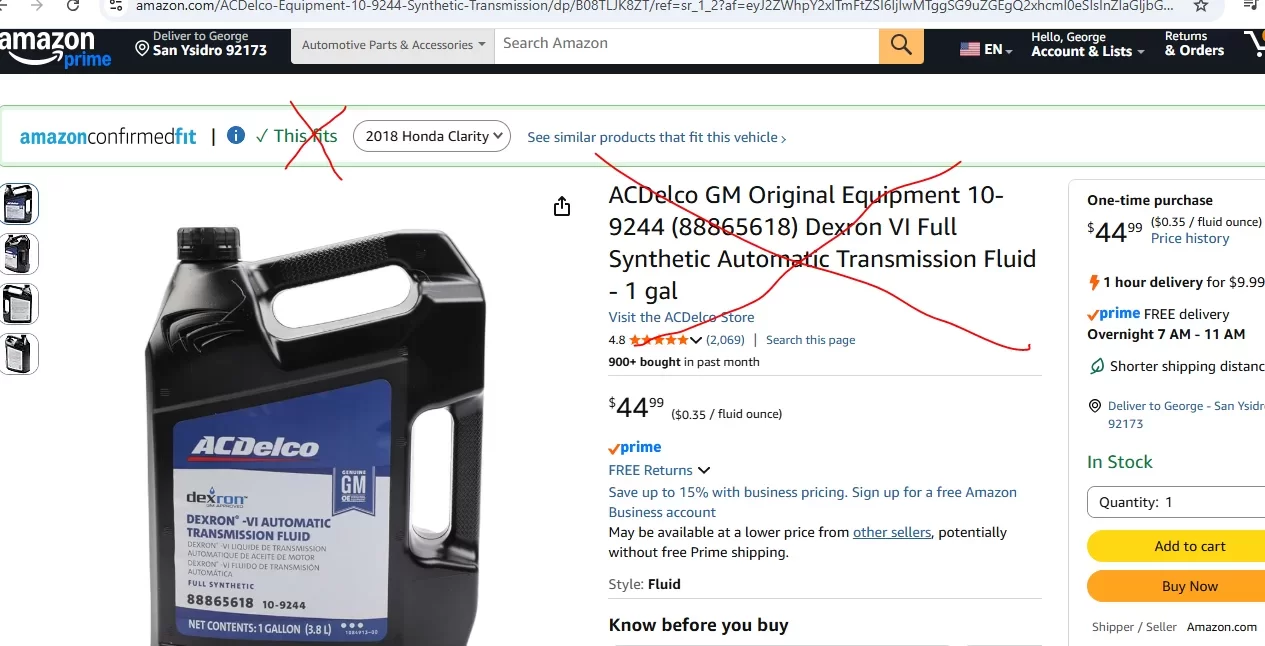

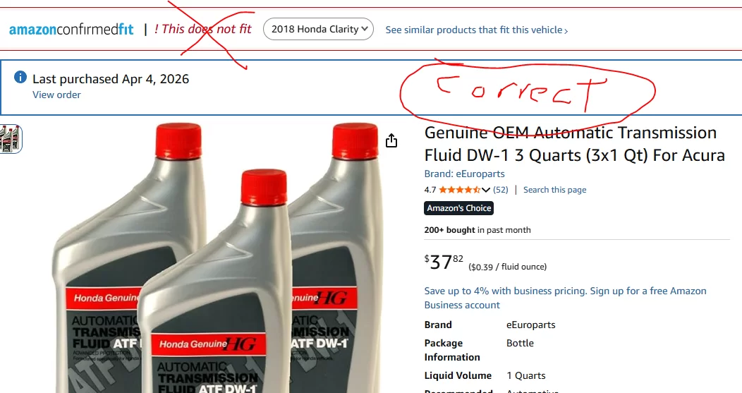

Just to give people who are not good with working on cars support, this novice with his hands changed the transmission fluid in around 40 mins. If you here on Amazon and click other sellers, you can get 3 quarts for $34. Amazon says that it's not compatible with the Clarity, but it definitely is
Get some crush washers, a funnel with a 3' tube attached, and watch one of many YouTube videos on changing the Clarity's transmission fluid, and you'll be golden.

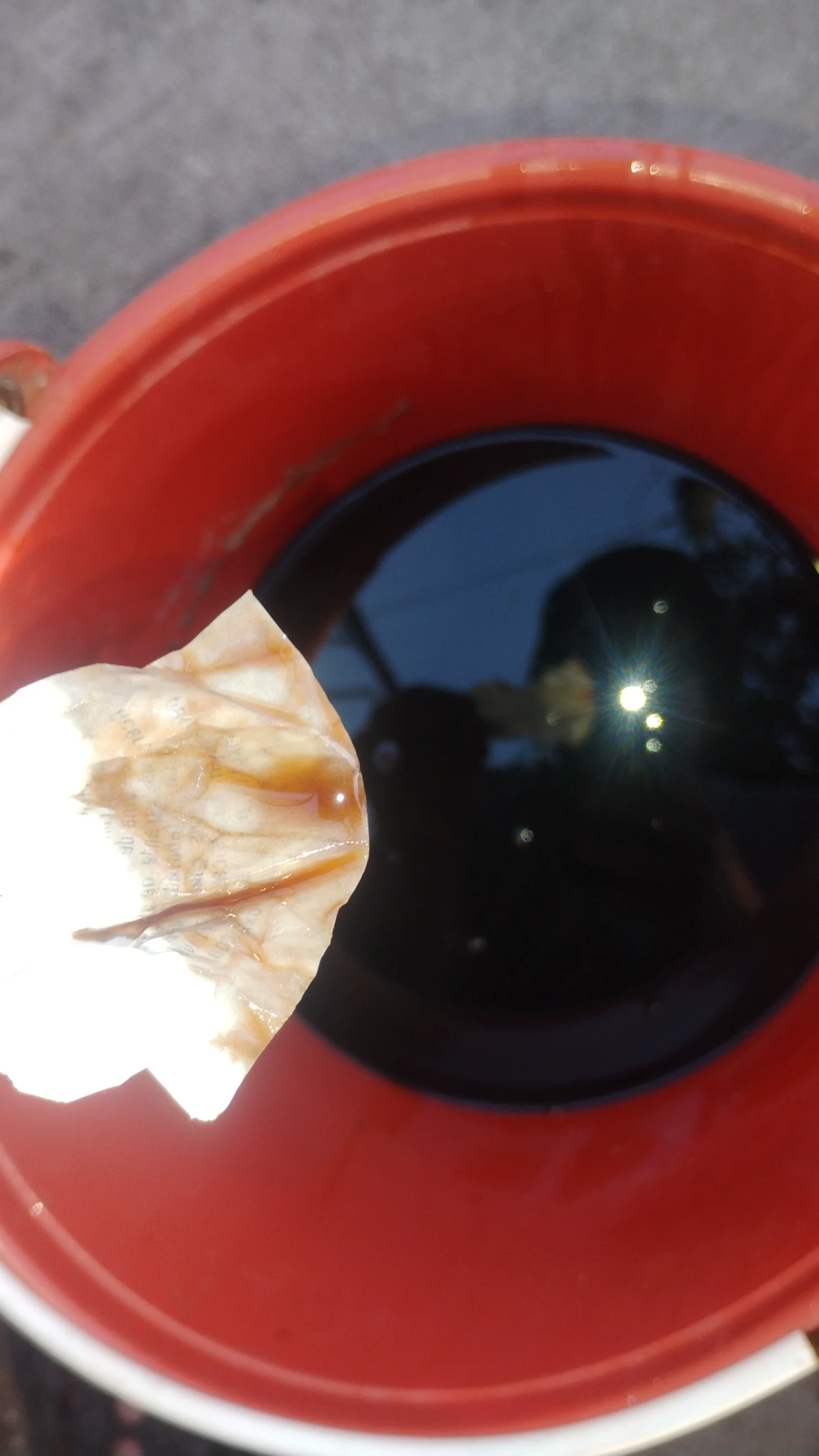

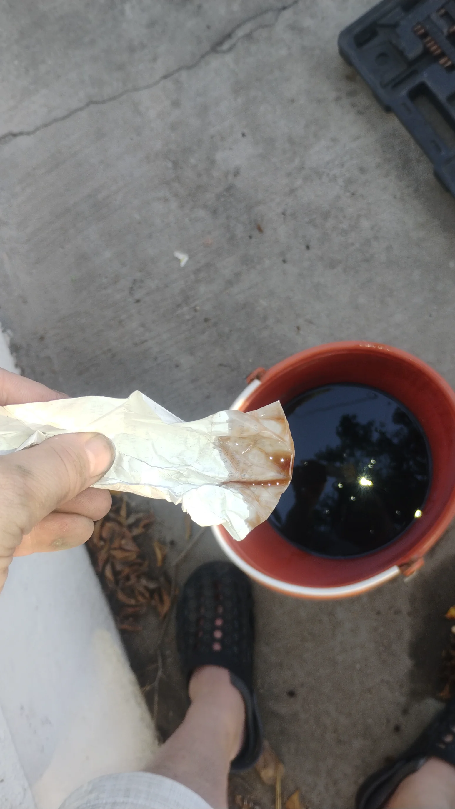

I waited until 75K miles and 8 years, which is probably way too long, as my old fluid demonstrates. The new one looks like that red soft drink that I drank as a kid
- posted pic to be funny. Sorry that I didn't photograph the new fluid, and I gave the leftover to a friend .
My point is not to think this is overly difficult. It's similar to an oil change without a filter change. Old fluid is in pictures
