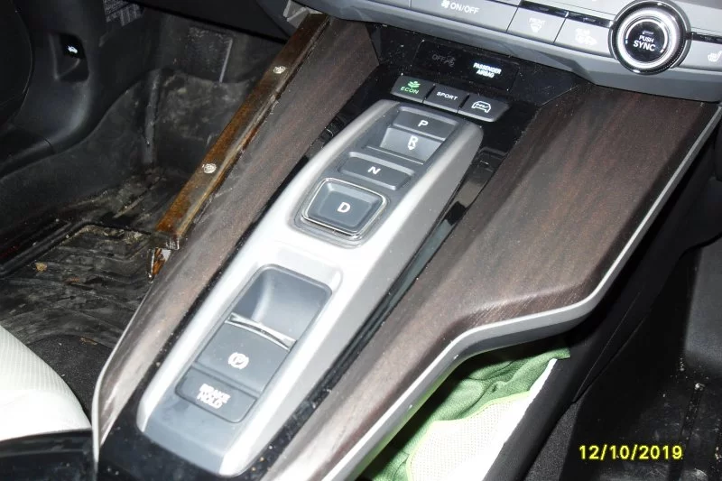

In case it helps anyone, here are Honda's disassembly instructions for that part of the trim. [Formally this is the Central Console Panel.] Unfortunately, a) it would look pretty unfinished without the wings; and b) there doesn't appear to be much reason for them at all, which is annoying.

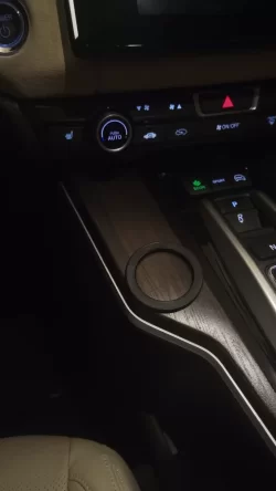

I do use mine to hold my cellphone.

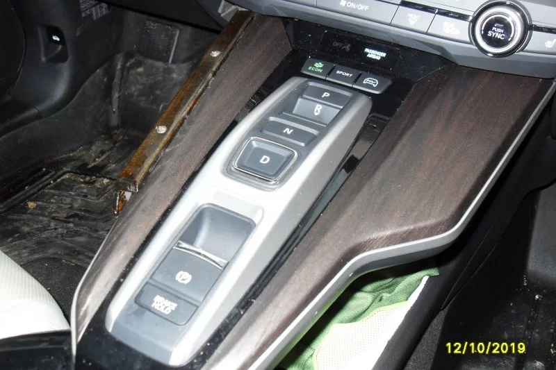

If you were to remove the right side of the wing as I did on the left, you would loose the second attachment bolt. There is a bolt under each heated seat switch. The console remains solid with one side removed. With both removed, that would not be the case.

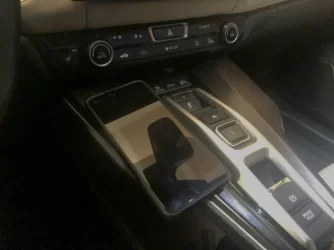

For those who don't have knee clearance issues, I ended up using the wing to hold my phone, using one of those sticky mats that works a lot better than I thought it would. It's really nice to be able to stick my phone there and plug in the USB-C cable with one hand.

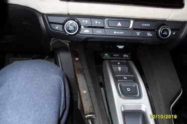

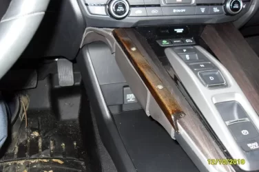

I got rid of mine and used a piece of real wood for trim. MUCH better. I'm 6'3".View attachment 6913
How did you get rid of the wing?

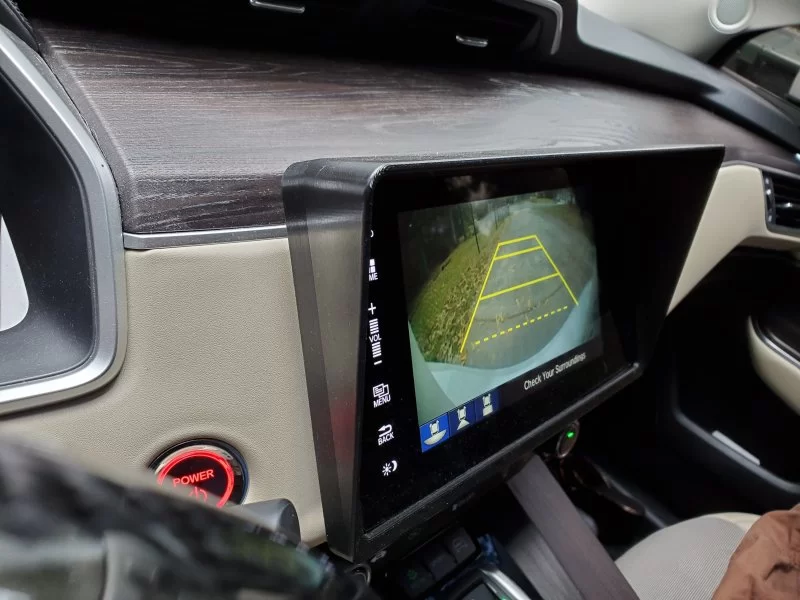

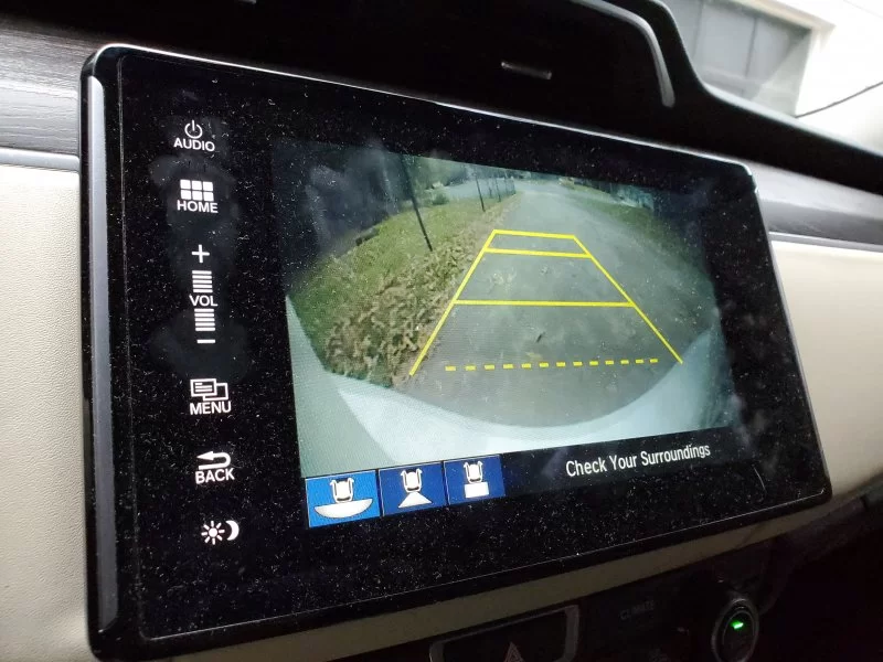

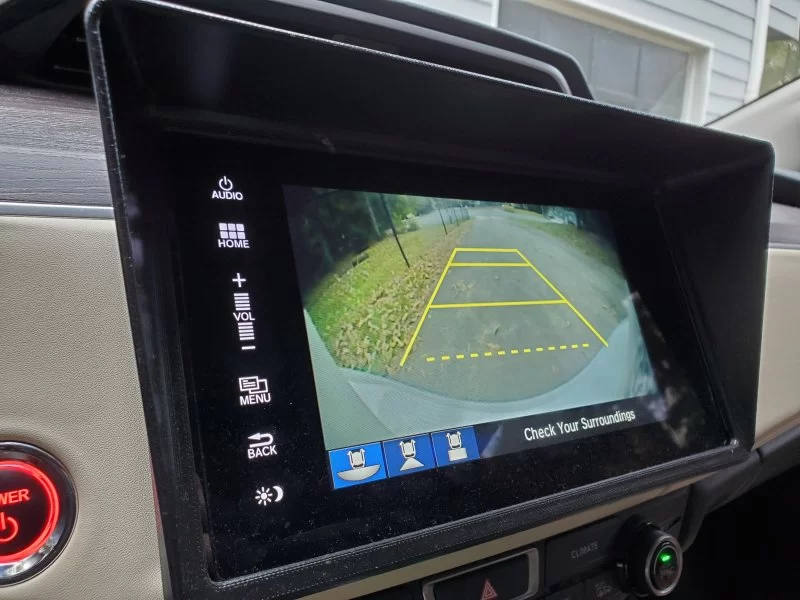

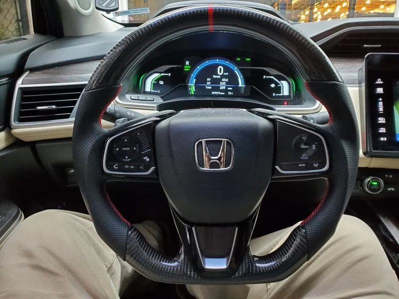

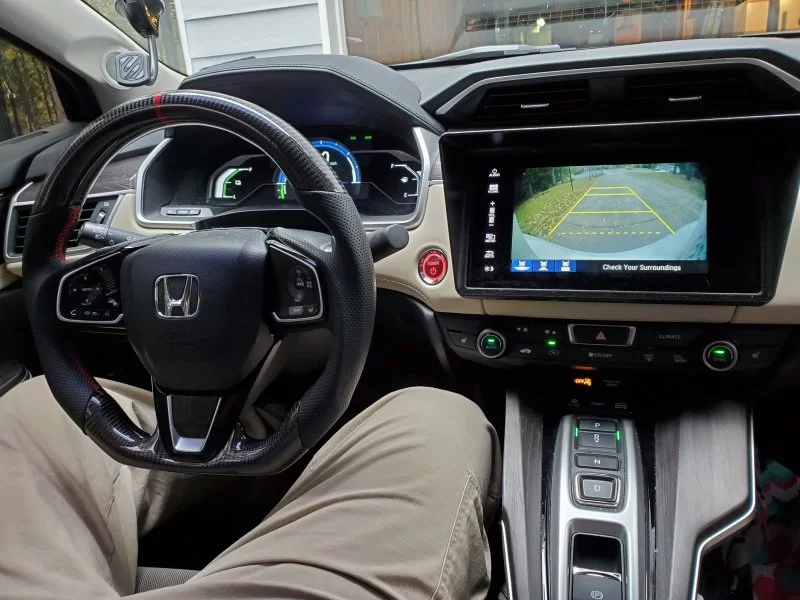

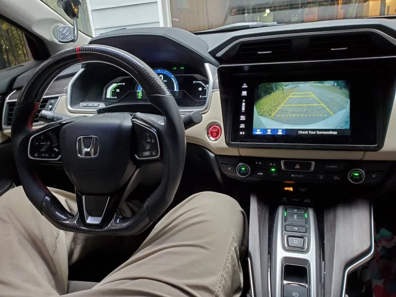

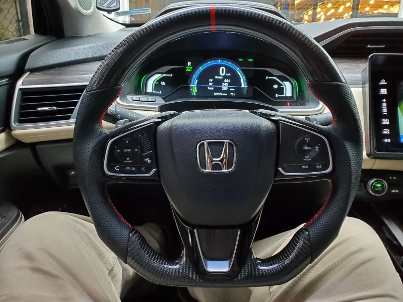

6'1" here, and work in a prototyping shop with access to great tools. This was my way of dealing with the wings in April of 18.. along with a few other items ;)
View attachment 6598 View attachment 6599 View attachment 6600 View attachment 6601 View attachment 6602
How did you cut the wings out? Did you use a circular saw and did you need to take out the center console out first and reinstall it? I guess there are no critical elements in the areas that were cut out? Thanks again!

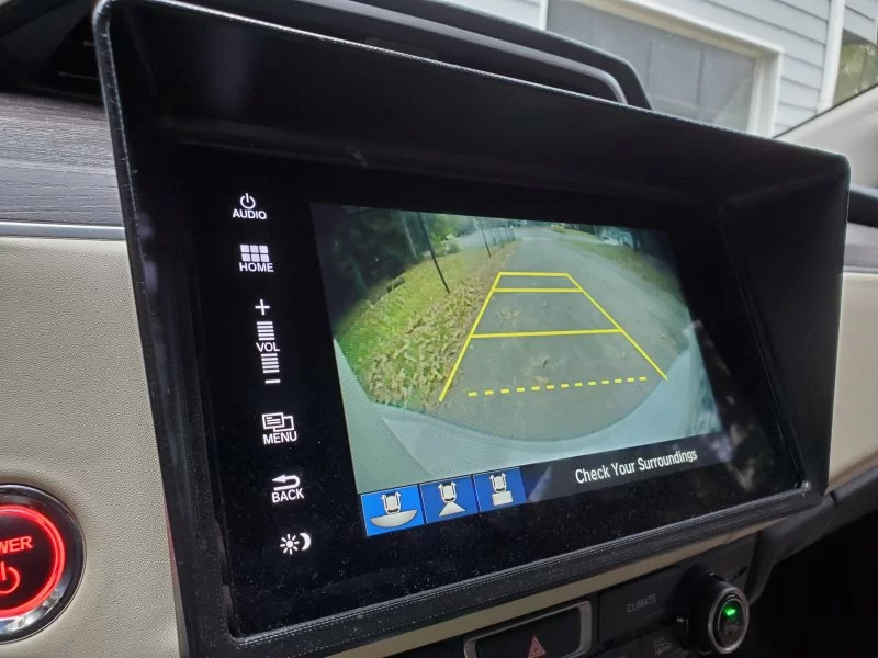

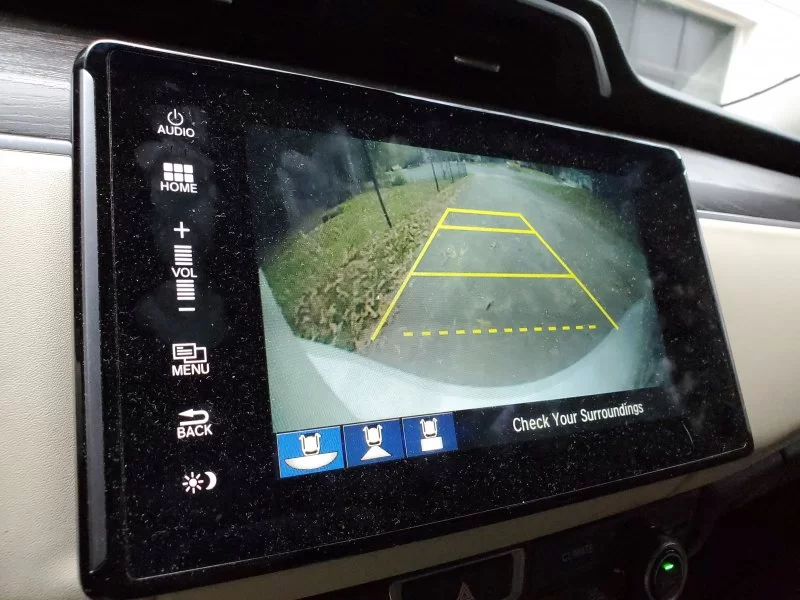

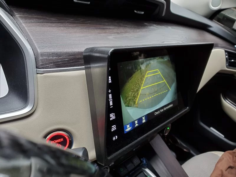

I know this post was too much time back ago but if you are still around, can you share where did you get the pictured items?, the steering wheel looks great (pretty much for the leg clerance) and the plastic around the screen, did you get in Amazon. I tried to find something that may fit the screen like this one.
NVM. I just found it. Here is the link just in case if someone is interested. https://www.aliexpress.com/item/2255800959747732.html?gatewayAdapt=4itemAdapt
