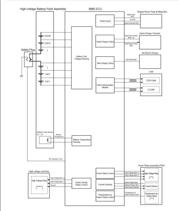

I would assume the CMU has a connection to each 3P cell group (98 connections total)
Curious just how much of an imbalance between the individual cells in that group would trigger an error code. If one cell were completely dead, the other 2 could pick up the slack even with a little help from adjacent healthy groups. A condition over time that would be more distinguishable, but in the short term may be overlooked. :oops:
Curious just how much of an imbalance between the individual cells in that group would trigger an error code. If one cell were completely dead, the other 2 could pick up the slack even with a little help from adjacent healthy groups...
Yes, that wiring is indicated in the docs, see blurry image below. The 3 cells in a parallel group have the same voltage of course but certainly one slacker would only have partial influence on the group balance voltage. Since they are wired in series, I don't see that adjacent groups could have any influence on each other in regards to balancing.
I think the value of 100mV was from the pass/fail battery test required before applying Campaign 960, the earlier BMS update.
