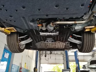

2) Anyone noticed whether the unit on Clarity PHEV is exposed or hidden behind underbody airdam?
A view from underneath... It seems to be exposed. It is a few feet behind the access panel for changing the oil.
Of course, there is little ground clearance. It is not possible to crawl under and get to it without jacking it up (or ramps).
Note - a new converter assembly costs around $1000.
