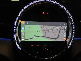

Okay, traded in a 2019 Countryman and got our 2022 SE today and the most notable thing is that the CarPlay is stuck in fullscreen mode. Which, while it looks cool ends up losing a lot of functionality.
If I hit ‘Options’ I can see that there is a split-screen option grayed out (I was able to turn it on in another menu and it shows the status of the setting - it’s currently checked) but CarPlay doesn’t seem to honor the setting.
Looking at YouTube videos (usually from Mini) all the ones that I’ve seen show the split-screen mode. Of course, this isn’t the same as Apple’s own split-screen within CarPlay.
Without split screen I can’t see what music is playing while the map is up so it’s really annoying to be missing it!
Anyone know if it’s supposed to be like that or is something screwed up?
Here’s what it looks like. Sure the map is nice but it’s a whole lotta map.

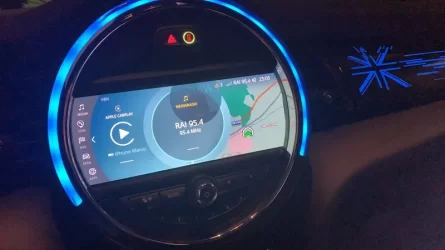

New 2021 graphic
